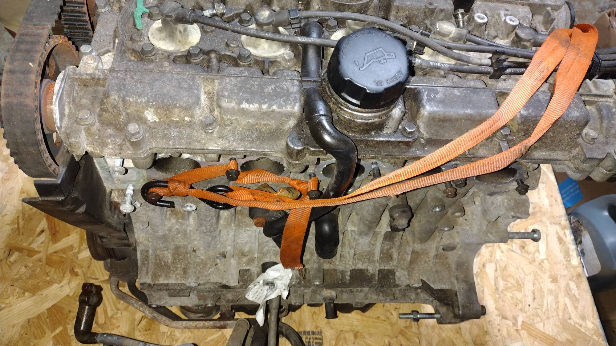

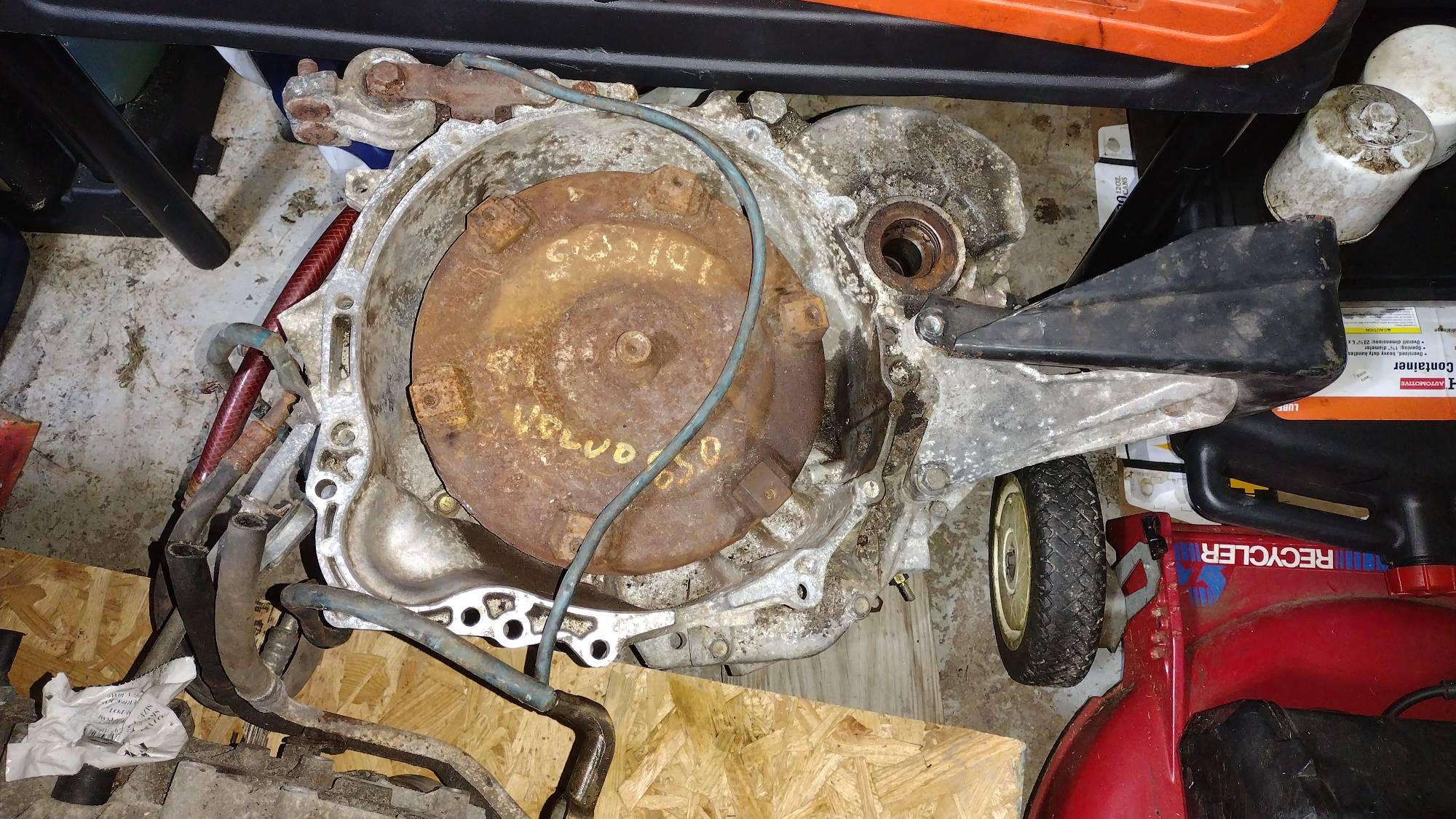

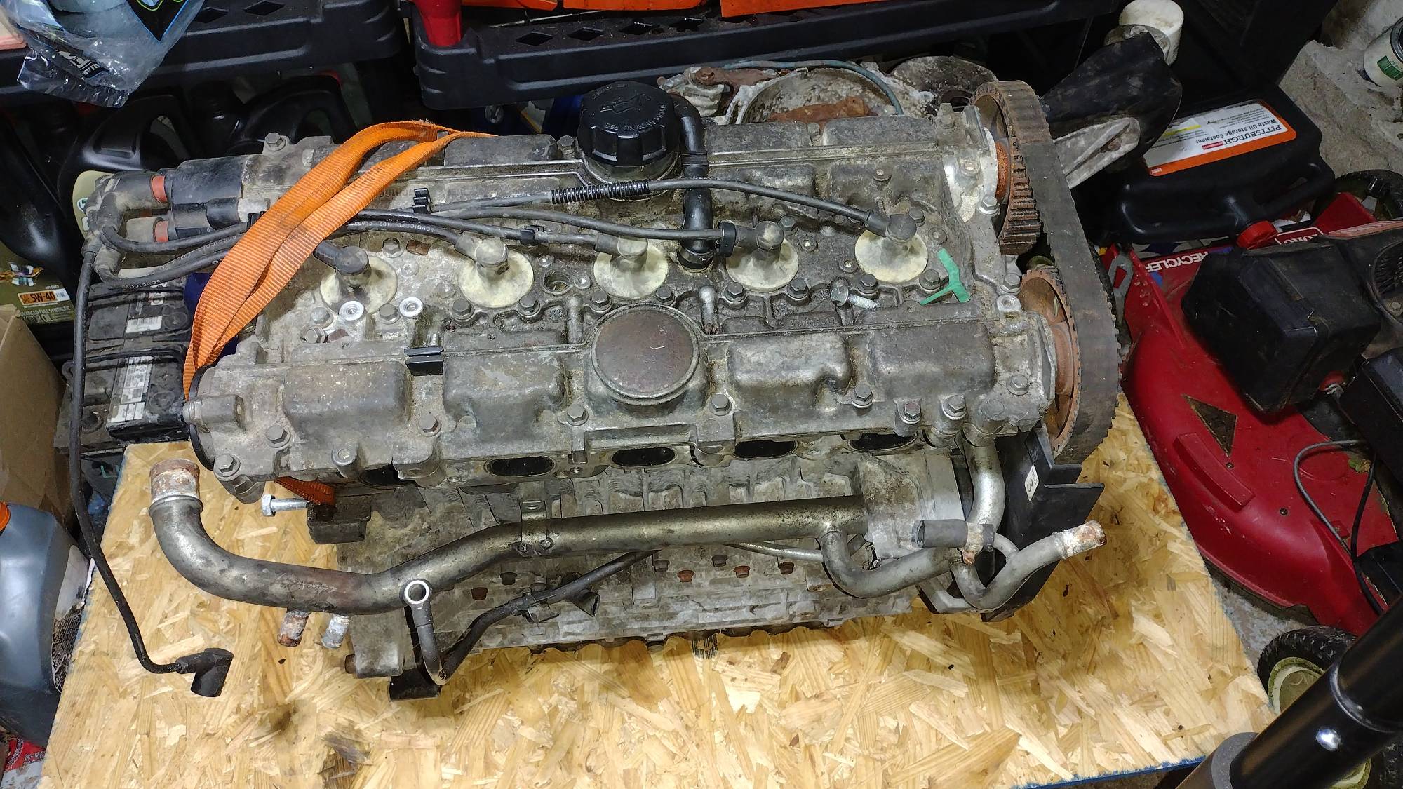

Currently getting the outside cleaned up, then I'll blow out all the holes. Was planning on dumping a gallon of marvel mystery oil in it just to wash any debris down into the bottom of the pan and help get things lubed up. Also shoot a little oil down the cylinders. Will reattach the flywheel and starter so I can crank it over quickly and check compression (and possibly oil pressure). Unfortunately, I don't have the infrastructure to test run the engine outside of the car.
Now for some poorly taken pictures.
