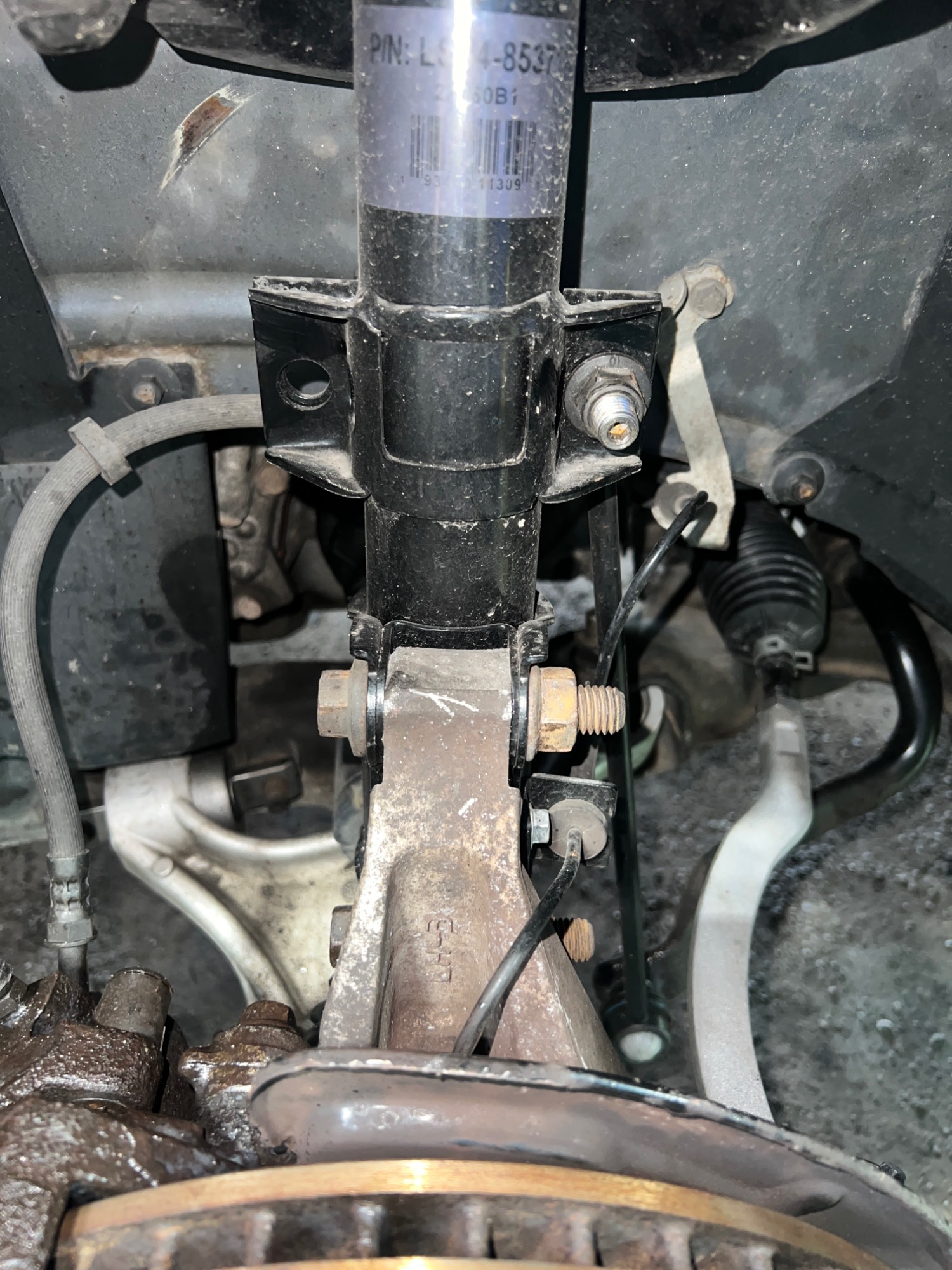

Okay, I took another look today when I did my engine mounts. I took pictures of the knuckles and let me know if you see something wrong there, I’m not sure I do.jonesg wrote: 08 Sep 2023, 15:56 the loose bolt is critical to hold strut to knuckle, you can't drive it like that.
I'd agree you had a klutz of a mechanic.
to solve the mileage problem requires digging deeper , reading fuel trims are a good way.
I also took a video of the sound source, although it doesn’t quite capture it, but there is a creaking noise coming from the top of the strut at the mount. It’s on a lift there so I don’t fully understand how that would affect it, but the angle is questionable to me and they do not seem even. Idk what they did but there is something wrong.
Also super pissed since it is not the part I agreed to pay for (they put in preloaded duralast, which I would have done myself if that’s what I wanted). I also have a pic of it under load at the bottom.
Last a picture of the mount under load
Struts/shocks/springs are always something that scare me to work on so I know nothing about their proper installation but judging from other final products this seems very off to me. Happy for any input since I will be questioning my mechanic about it and I expect him to weasel his way out of any complaints.

Maybe the strut bearings or spring seats are poor quality? Everything looks ok in your pictures. Can you hear anything when the car is on jack stands and you have someone turning the wheel back and forth? What brand are those strut/spring assemblies?

On jack stands with wheels off, I get a weird creaking noise from the top of the struts. You can hear it in the video I postedBlacklab467 wrote: 10 Sep 2023, 21:07 Maybe the strut bearings or spring seats are poor quality? Everything looks ok in your pictures. Can you hear anything when the car is on jack stands and you have someone turning the wheel back and forth? What brand are those strut/spring assemblies?
