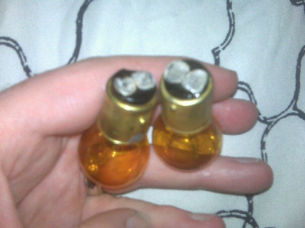

Mystery Solved!
I found a suggestion on BrickBoard. Replace all the bulbs thye say... Sounds simple right??? Well The Right Turn Signal has two electrodes on the bottom that have solder contacts. The solder melted together, and all those 12 volts go in the direction of least resistance...
I have replaced all the bulbs. Thanks for all the help!
