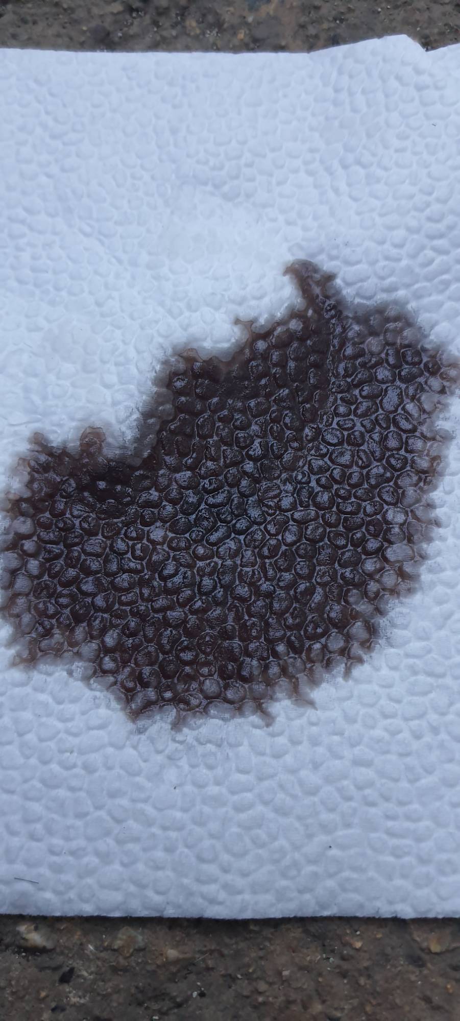

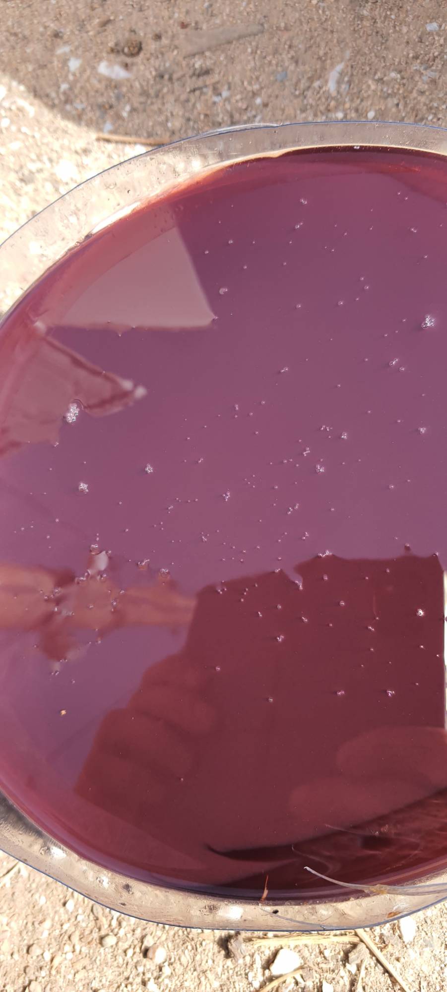

My atf was very contaminated. The first time i ever did a drain and fill it was like used diesel oil. Pitch black
Pictures speak a thousand words don't they. The first picture is already at 6 or 7l drain I ever did.
The last picture is after 30l(31 quarts). Better but not fully.

Looks like your torque converter clutch is gone, dikidera.
