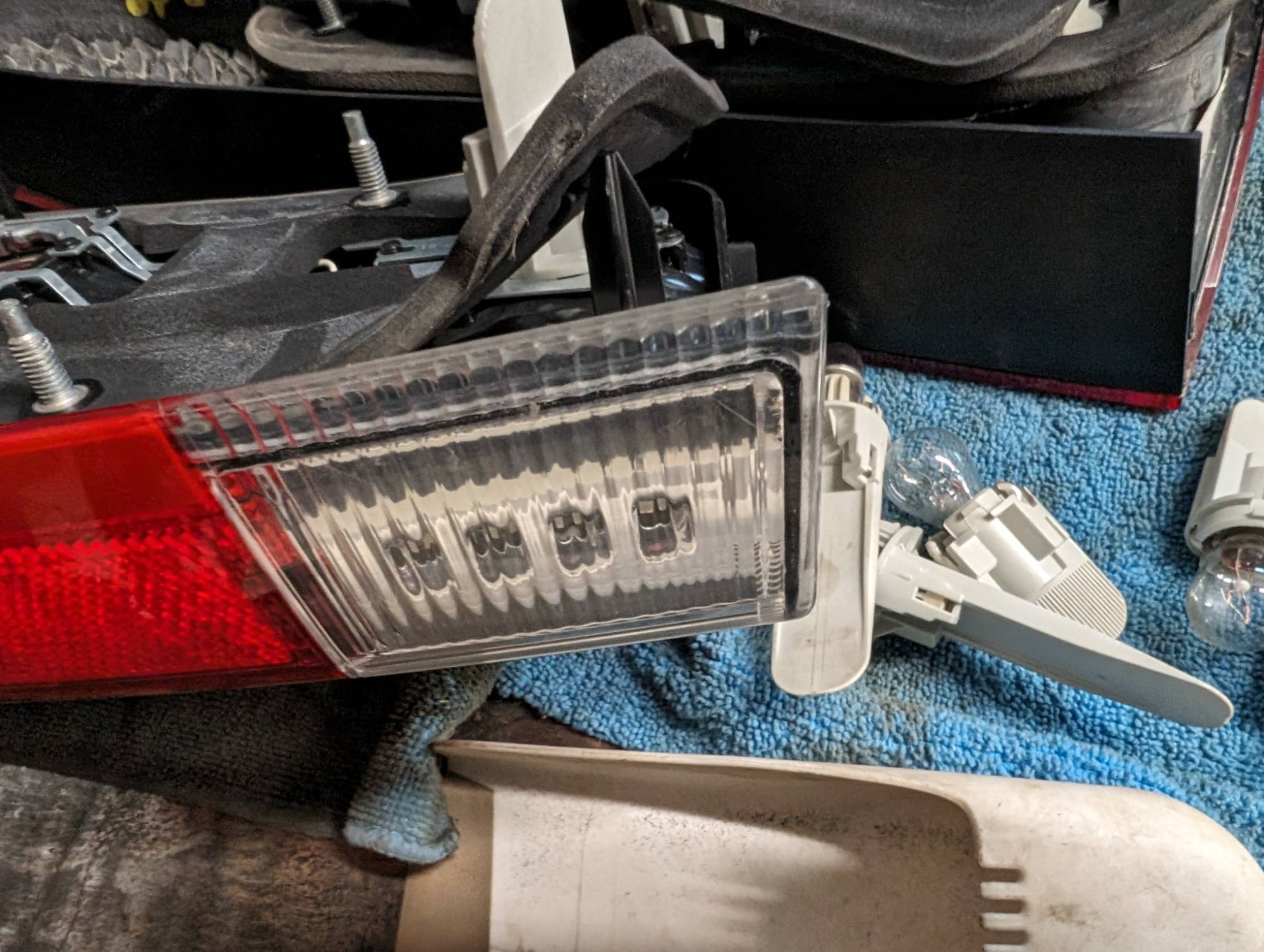

Thanks Eric. Only just saw your answer here. The dealer parts guy followed up and said it was the rear marker lights? I took a look at the car again and as the garage was darker, I saw a reflection at the bottom of the lower taillight unit with what looked like 4 small bulbs. I just pulled those '05-07' jewel taillights and I took a look at one of those. I Guess the size of it and the price threw me. It is maybe 50 x 25mm in size and held in by 2 tiny T10? screws behind that aluminum plate in the picture. I was expecting something closer to the lower light section for that crazy price. Now I just have to check if ours work!
Appreciate your help again!

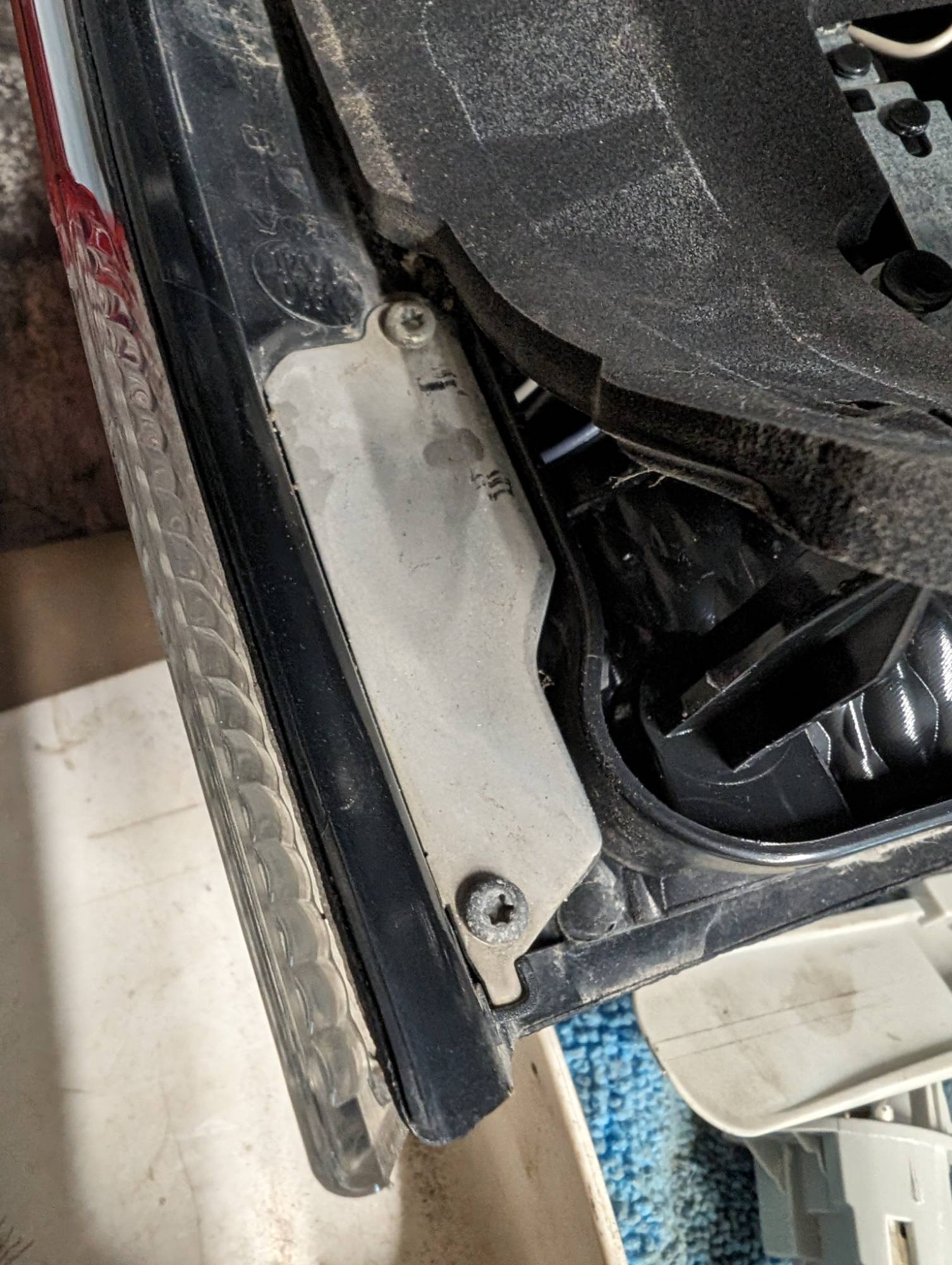

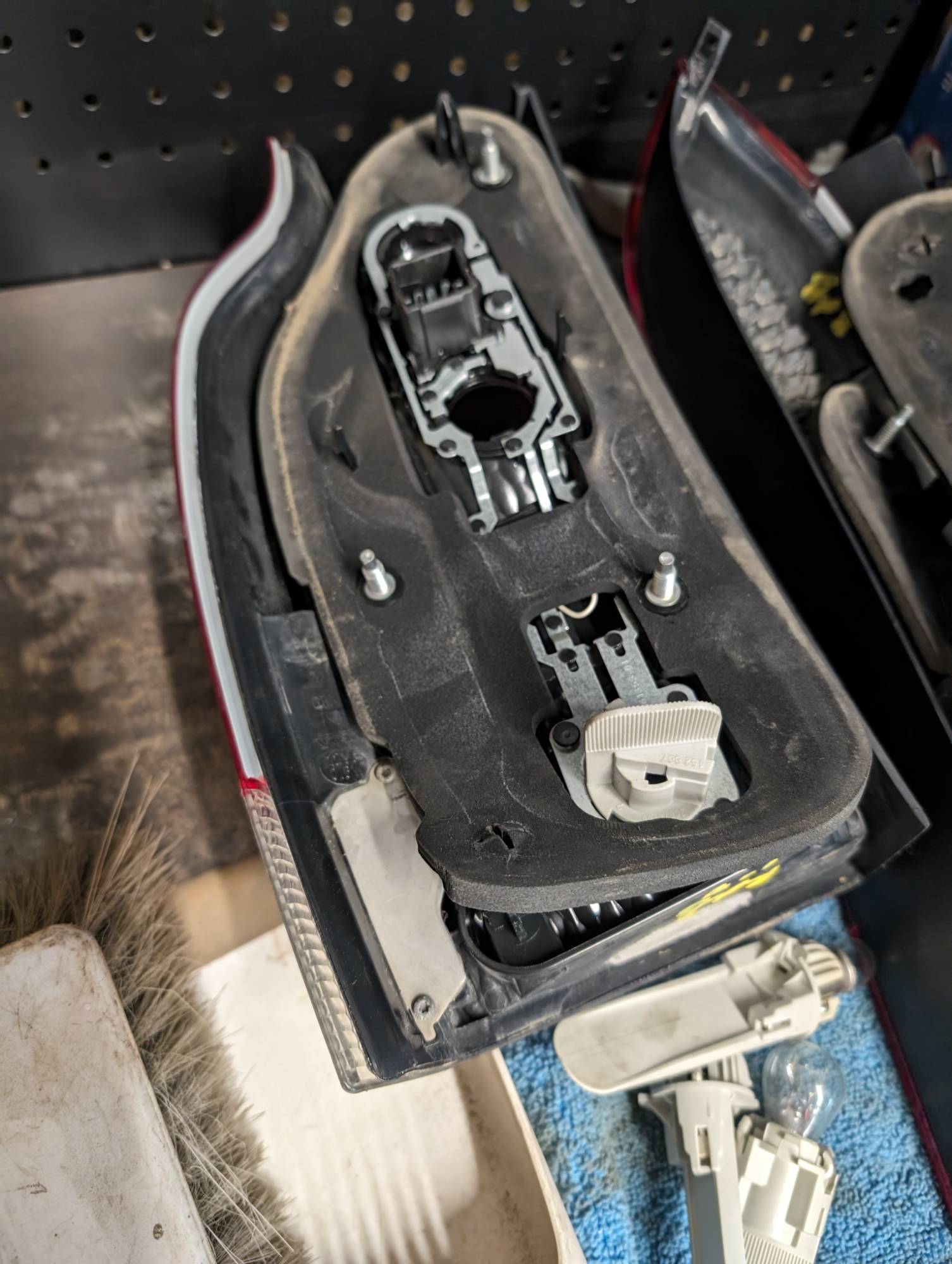

Just to fully close this off, here are a few pictures of the location of this offending item!
The part is hidden behind that little grey metal piece at the lower left of the light unit.
Well, I guess we now all know!
