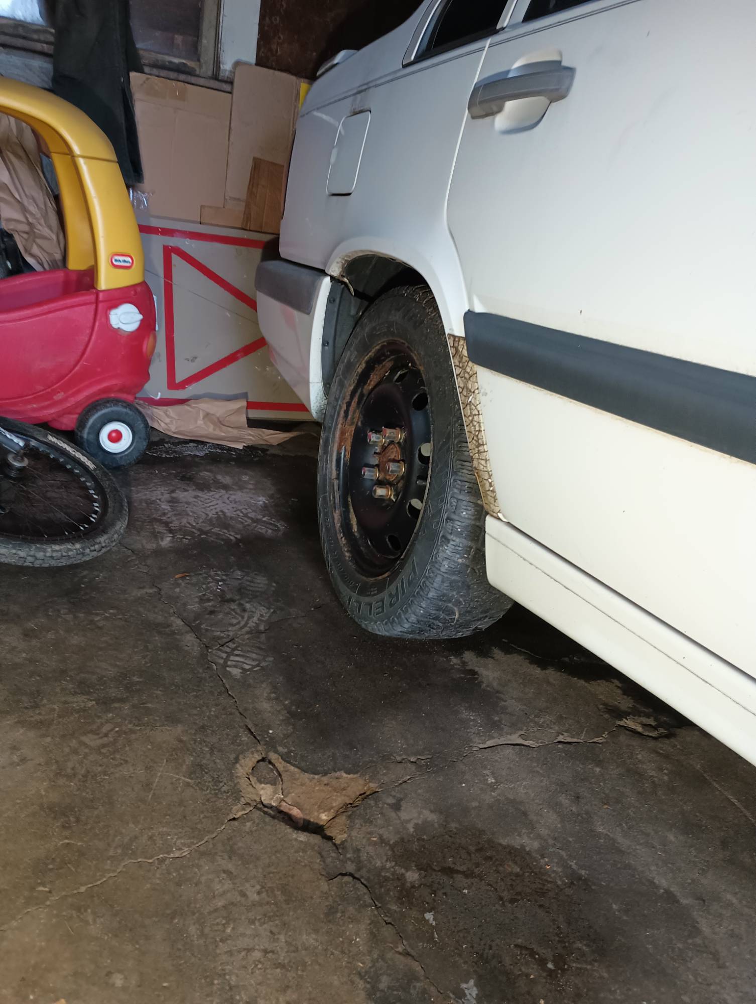

The rear is going to be a whole 'nuther sport. How far out is it ? Was the wheel destroyed, or is it just curb-rash level ? If you are very, very lucky it might just be a bent panhard rod ( 9157297 ), putting a twist in the trailing arm bushing.

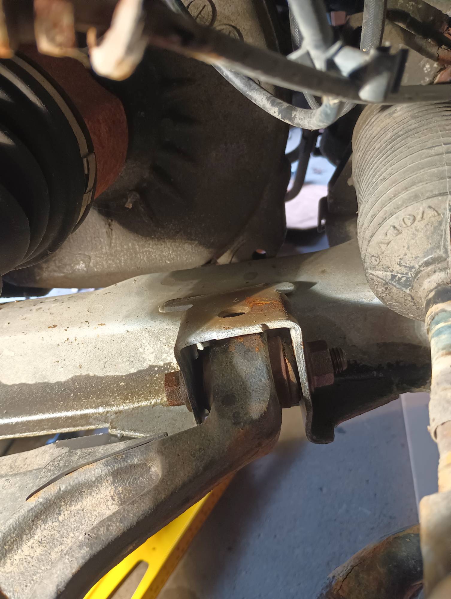

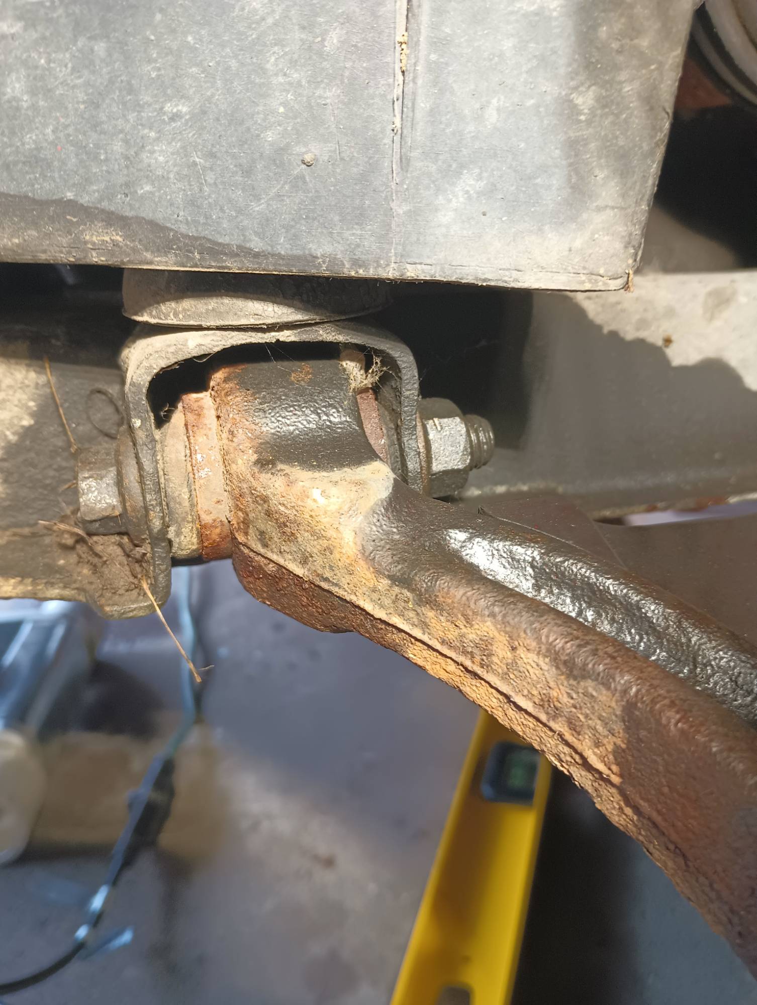

I have attached a few pics of the driver-side control arm and the back wheel passenger side.
I haven't gotten around to looking at the rear and figured I would get the front figured out first.

I just went through this myself. If that control arm mounting area to the subframe isn't bent, leave it alone. I nailed the curb so hard I bent the subframe and hand to replace it. In your case, even after replacing the front strut assembly, REPLACE THE KNUCKLE. Also! You're going to need to pull a new trailing arm for the one you most likely bent in the back! They're not hard and I just did the job myself in my driveway without removing the entire rear end suspension. Lmk if you need help or advice like I said I JUST went through this last month!

It may be the pictures, but the mounts for the lower control arm look twisted slightly counter clockwise?
- BlackBart
- Posts: 6728
- Joined: 10 Dec 2016, 17:03
- Has thanked: 967 times
- Been thanked: 923 times
I'm not necessarily seeing that, BUT...1º off at the mount could make a big difference at the wheel.
