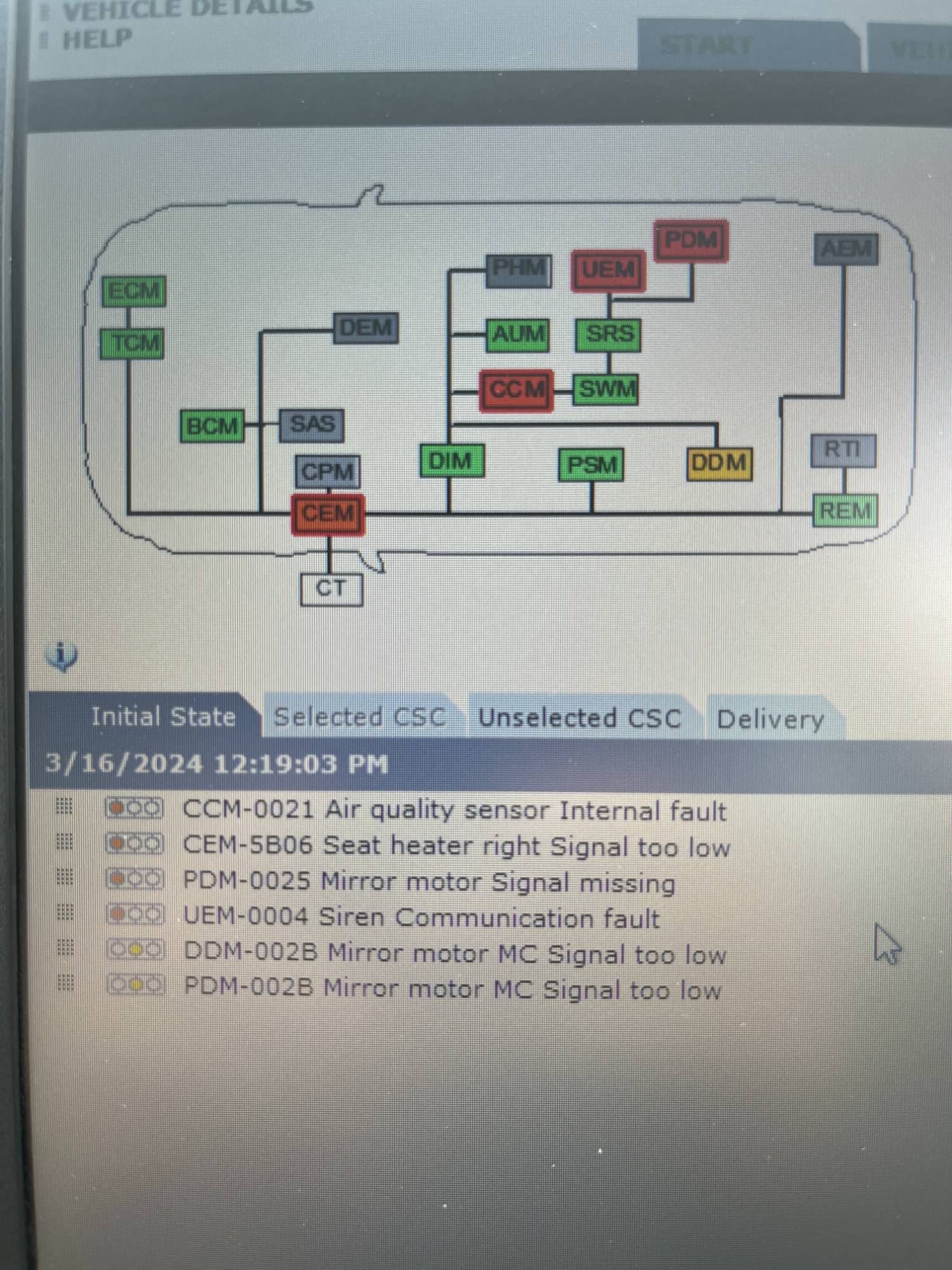

That didn't fix the problem though, the error message on the dash came on at first start up. I thought maybe it's a residual code and I had to clear it with VIDA, but that did nothing. My conclusion was that the new module was bad right out of the box, and so this weekend I replaced it with another one. Same story, the "alarm system service required" message came right back.

I was also wondering if there might be something else going on. I went in with VIDA to take a look, but I cannot tell if some of those codes could be interrelated. They seem trivial to me, but I'm no expert. I have heard about the sunroof issue, but that is working normally, as well as everything else in the car.

I'm no expert on electrics as you probably well know! However looking at the codes I don't think any of the other 5 have a connection to your issue or than the alarm communication fault.
Seat heater , mirror x 3 and IAQS fault seem to be unrelated.

Siren communication fault is why you get that Alarm com fault on DIM.
Its fault symptoms includes "Alarm does not work".
Alarm consist of multiple modules on P2 to create "Alarm System":
CEM, UEM, CCM, DDM, PDM, MMS, DIM, ISM, REM, Siren module and multiple Volvo Guard™ stickers at windows and switches here and there and or wires at windows.
Which ever your car is equipded with. not all have all.
scot850 did throw correct with being "mirror" for that.
If i would be i would focus at UEM module specially connection with its connection to Siren Module (16/35) (com is via Volcano Lite serial not CAN Bus).
Plus because VIDA is so lovely design.. Select "Delivery" tab not "initial State" if you used more than one time Vida on same car as you looking at history many cases.

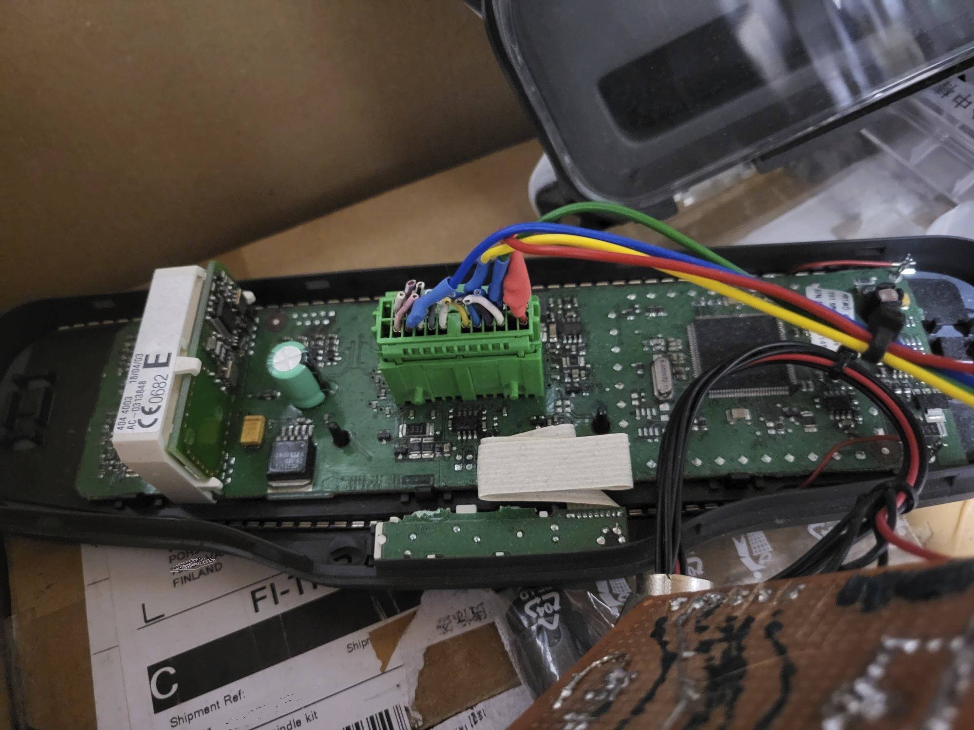

Its literally attached behind the mirror you staring in fear or in awe.br0dy519 wrote: 04 Apr 2024, 12:03 Does the UEM live inside the rear view mirror? I wonder because I had a leak in my windshield and has some gremlins for a while..
Edit here with picture.
