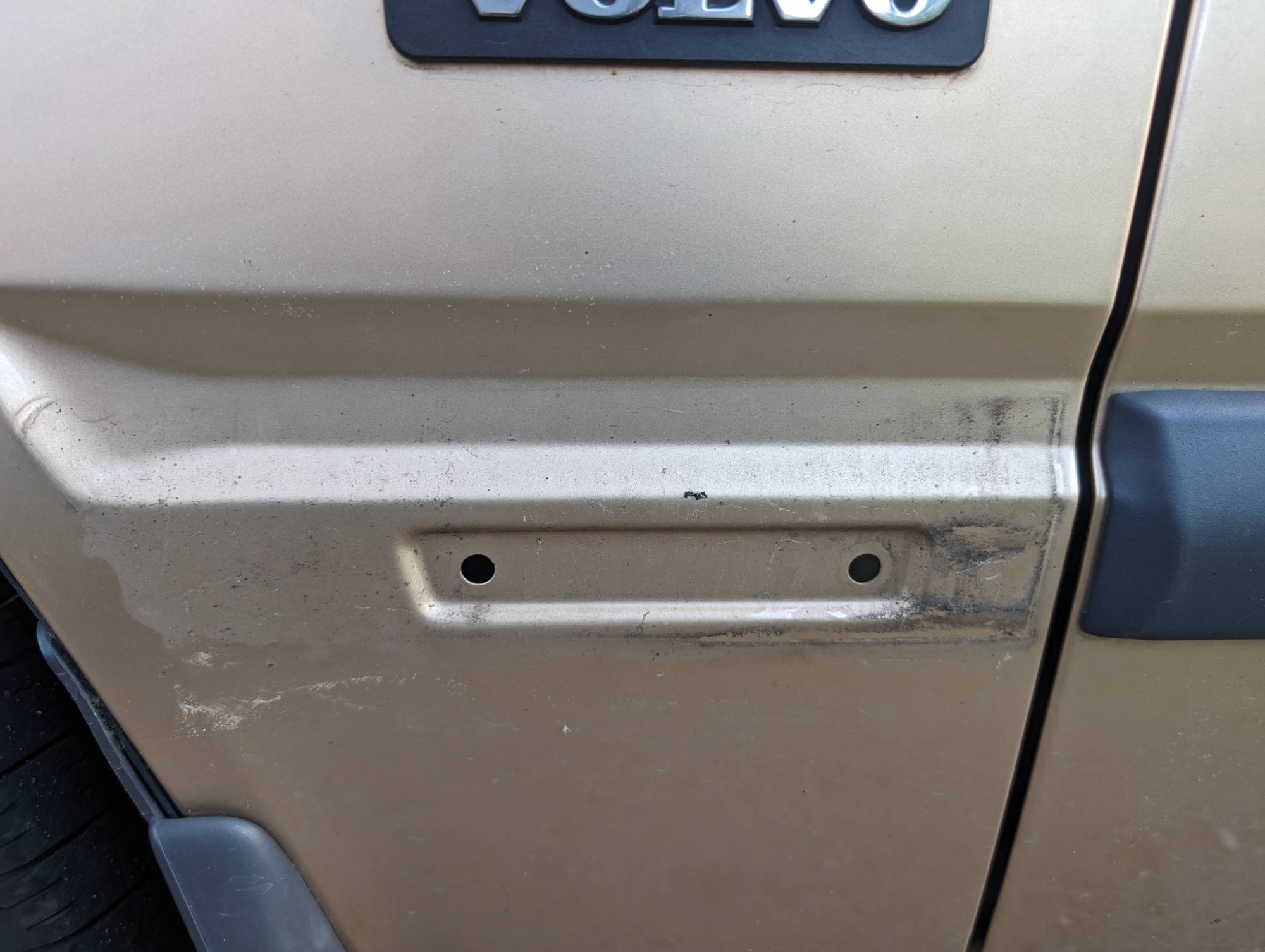

Here is the trim piece I'm talking about. You can see how I've taped it, to make sure it doesn't fly off on the highway.

I'm trying to recall what is behind there. I know the Volvo badge above can be removed to fit the side repeater turn signals, but the small trim nothing comes to mind. Were there any holes of any sort behind it? If not then it is double sided tape. I use one that sticks really well made by 3M.

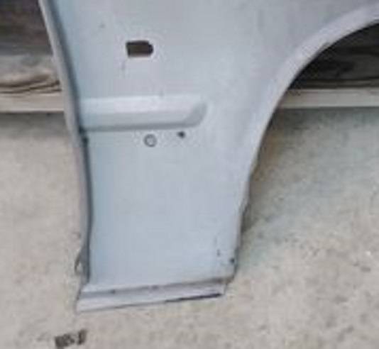

Here's a bad photo I had saved of an S70 fender I pulled from the junkyard. I believe the trim piece is similar to an 850 but I could be wrong. There's round thing and two smaller dots.
I've replaced that trim piece before on my V70XC when I replaced the fender...but can't remember exactly how I did it. The photo refreshes my memory a little bit. IIRC, you pull the ends slightly away from the fender to detach the two small studs from the fender holes. Then you slide the whole trim piece towards the rear of the car, to unhook it from a clip. Probably best to use a trim tool to detach the two small studs, but I don't remember using any tools on mine. Might be completely different on an 850.

rrres wrote: 23 Apr 2024, 20:37 Here's a bad photo I had saved of an S70 fender I pulled from the junkyard. I believe the trim piece is similar to an 850 but I could be wrong. There's round thing and two smaller dots.
Thank you. I do have a trim stick and will see what I can do with it.

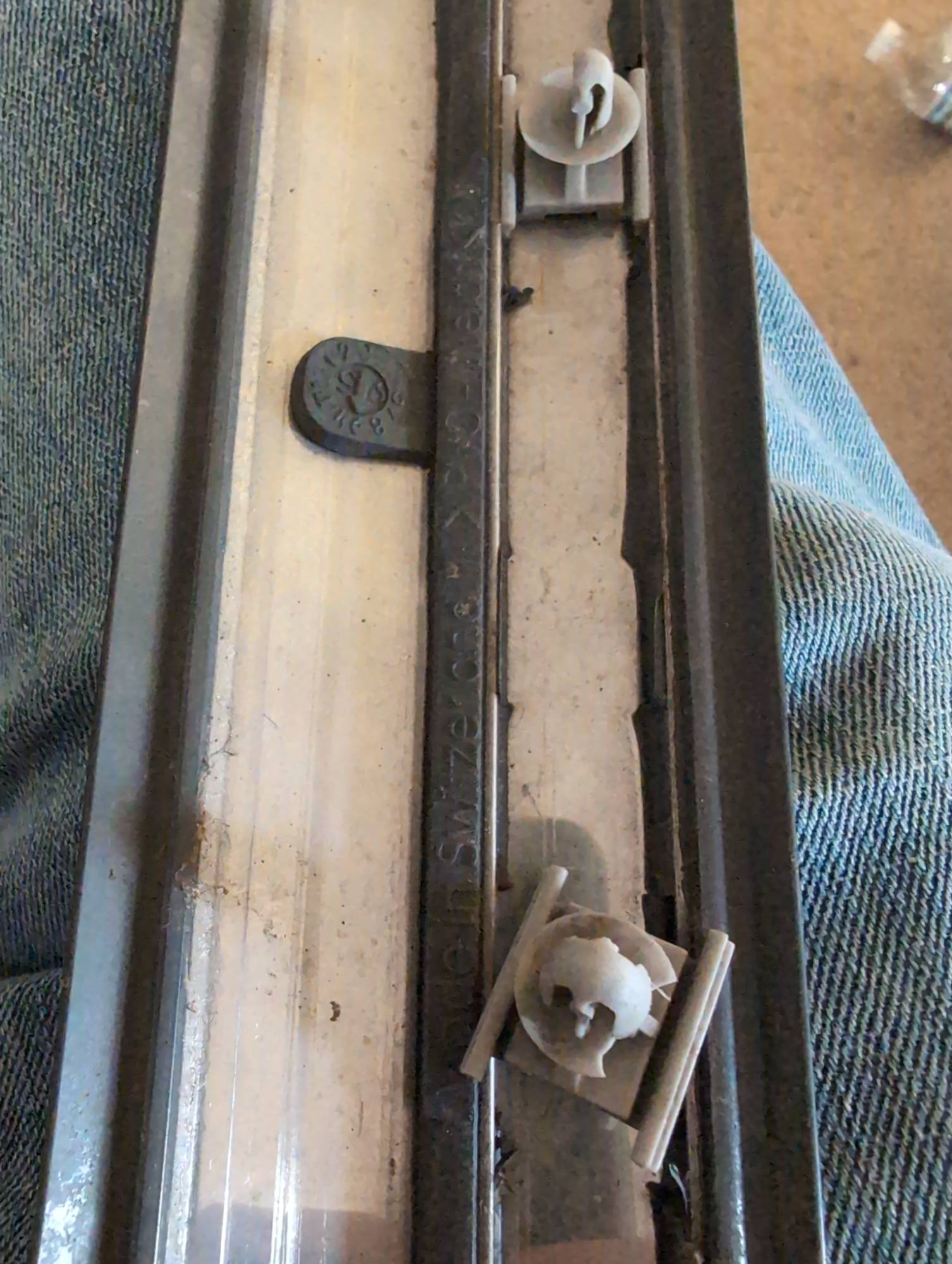

I got the trim piece off today. Here is what I found.
I've already seen these clips after doing a little searching after looking at Neil's link. It should be just a matter of ordering and snapping together.
