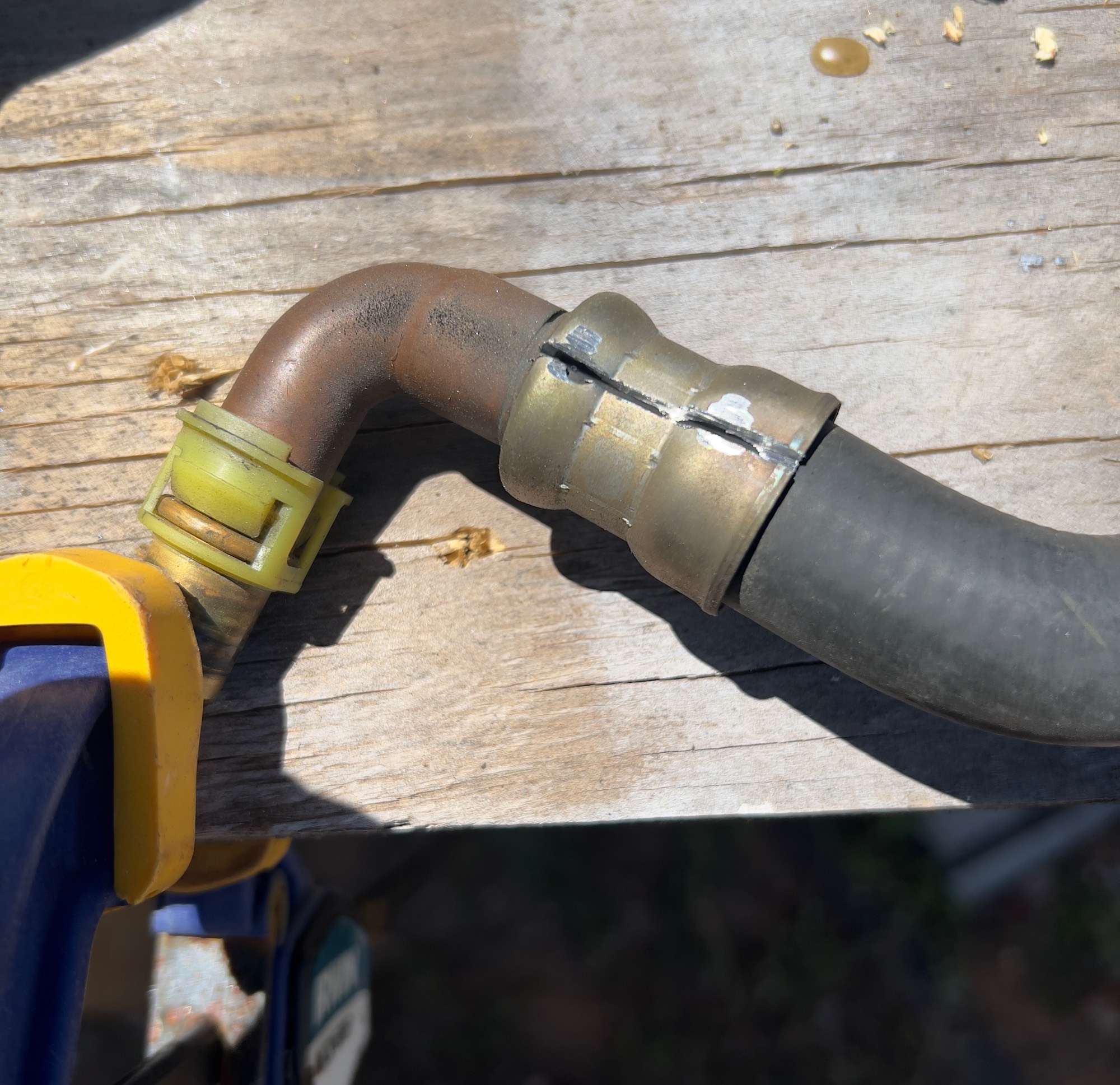

First step after removing the 2 hoses is to cut the crimp connectors from the copper pipes. I used a right angle grinder with a cutting disc. Clamping the hose to a work surface makes for a more controlled and safer cut.
Hose clamped to work surface

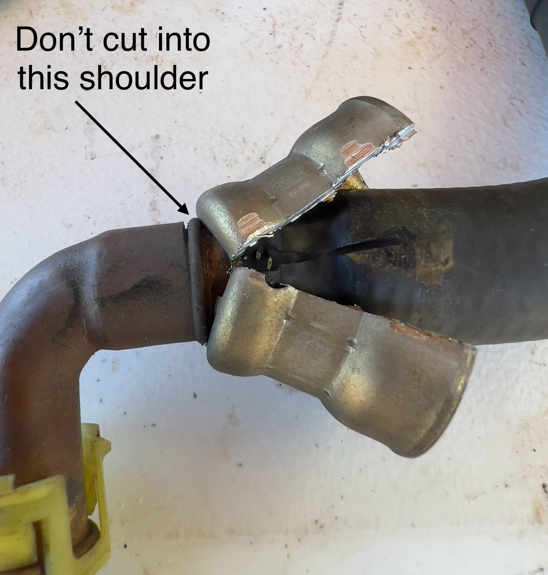

Cut the crimp connecter being careful to not cut into the copper connecter or the ridge/shoulder at the end of the connector. Cut both sides 180 degrees apart.
Here is a photo of how deep I made the cuts.
Cut detail 1
Cut detail 1
Cut detail 2
Cut detail 2
You don’t need to cut all the way through the end of the crimp connector that is perpendicular to the hose, it will break when you pry the two halves apart. This will help prevent cutting the ridge/shoulder.

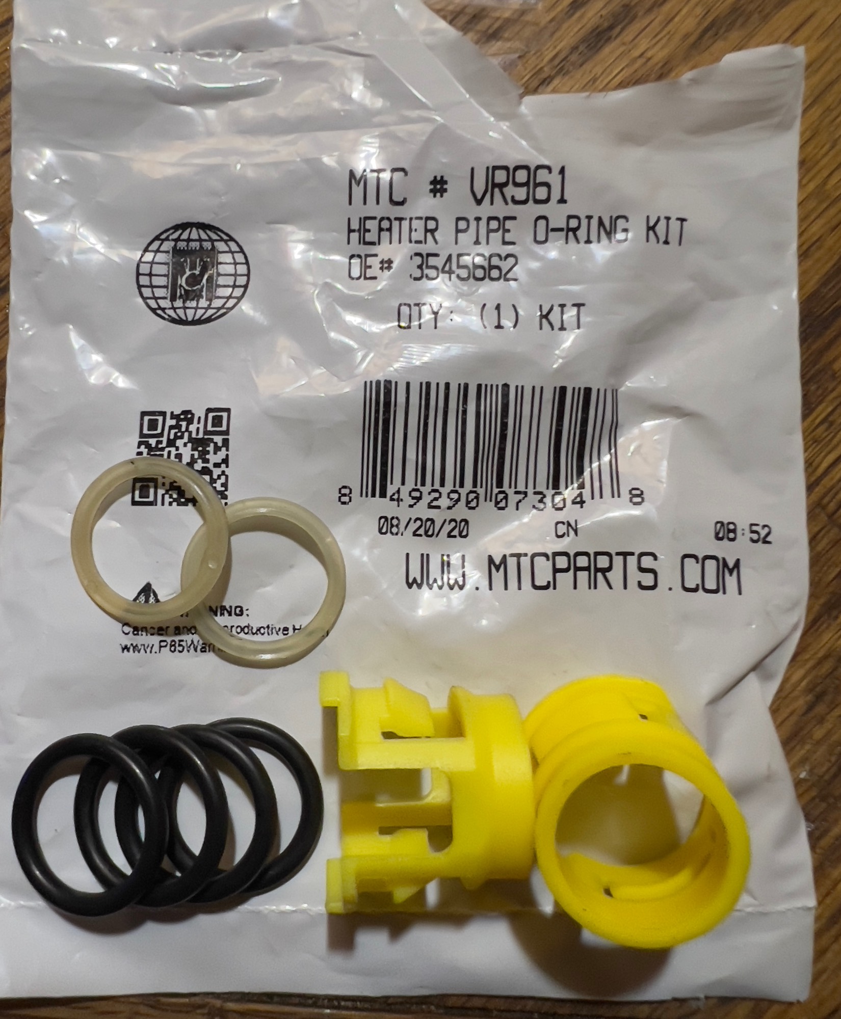

It’s a good idea to get a heater pipe seal kit and replace the plastic connectors and o-rings. I used this kit;

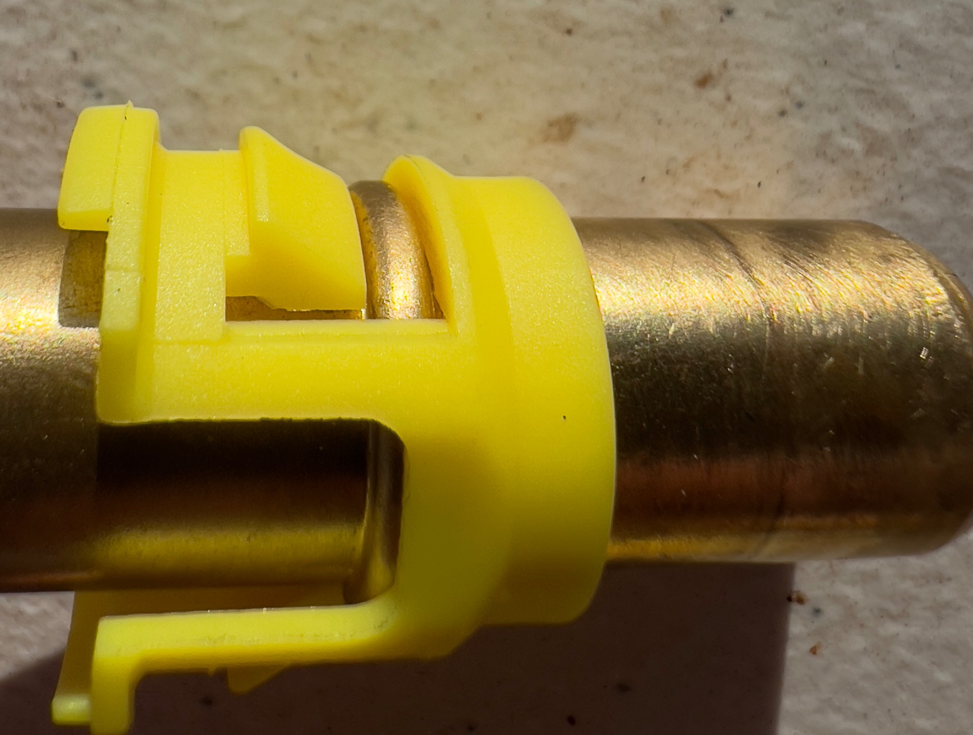

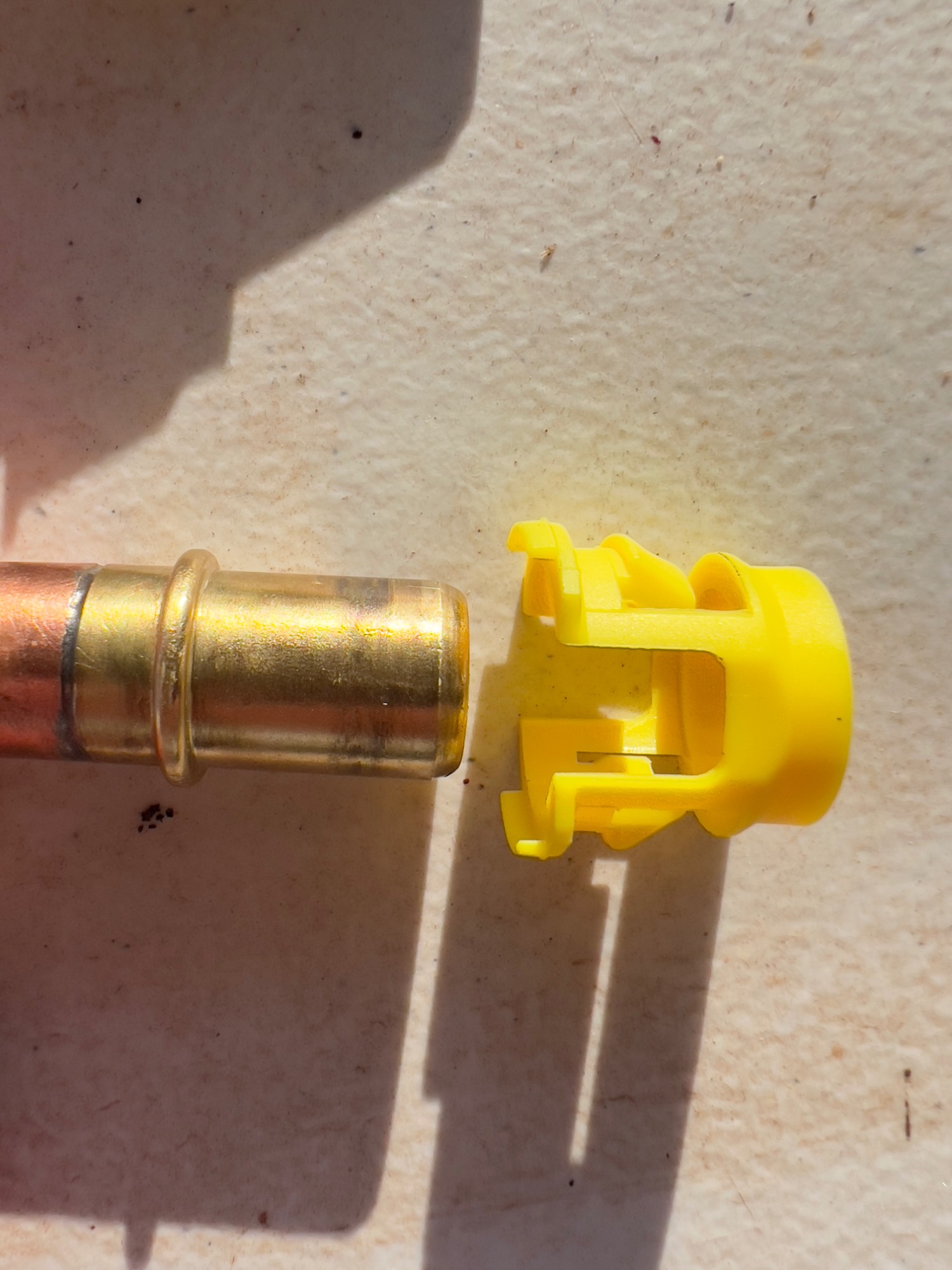

The plastic locks are simple to replace. Just pry up the plastic retainers and slip the lock connector off the pipe

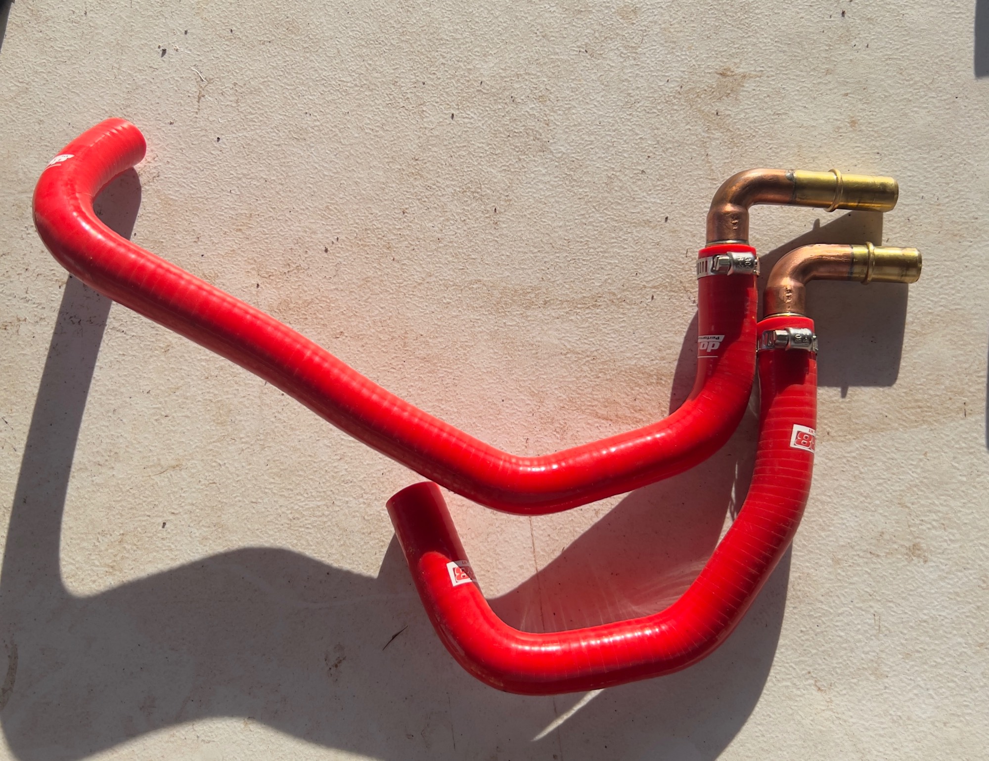

Install the new hoses onto the heater pipes and clamp. I didn’t have the correct size Oetiker clamps so I had to use regular hose clamps on both ends. I had intended to use Oetiker clamps on the firewall side as those connections will seldom need to be separated.

unlike blue, which always looks odd to me, the red hoses look legit.
