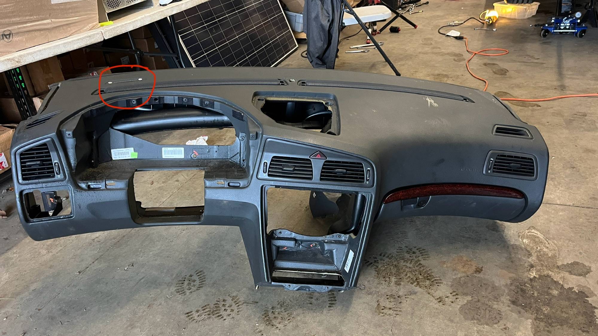

Hello, I am trying to find some help on a bit of a specific problem I've encountered.
TL/DR I'm swapping the dash from S60 to V70, vin plates are different, how do I take the VIN from V70 dash, so the new dash has the proper VIN?
I have an '04 S60 and an '04 V70R. I'm swapping the entire dashboard from the S60 in to the V70, but I forgot about the VIN plates on the front left of the dash. Is there any way that I'd be able to swap these over, would I have to bring the 2 dashboards to a Volvo Dealership and have them do it, as the rivets holding them in have the Volvo logo on them.
As a side note, I already have the dash out of the S60, I haven't pulled the dash from the V70R yet.
I personally don't have an issue with the VIN's not matching up, but I'm not sure if that's illegal and would probably lower the resale value.
Any help is appreciated, I would like to do this as professional as possible.

Post by ThrashEC27 »
It is located on the dash, just for reference I have circled it in this picture

Post by jonesg »
drill rivets out and reinstall, theres no law saying they have to be special volvo rivets.

Post by scot850 »
On a P80 it is held on with push pins, so easy to swap without damage. I guess the move to P2 they went to high security (?) rivets!
I'd also add, that if you were changing the Vin# to one other than the car it is to be on then that is tampering. Displaying the correct Vin is not tampering.

Post by chrism »
If you can access the upset (backside) of the rivets just grind them off and pop everything apart. Reassemble the pieces on the new dash with epoxy holding the plate and, what’s remaining of, the rivets in place.
