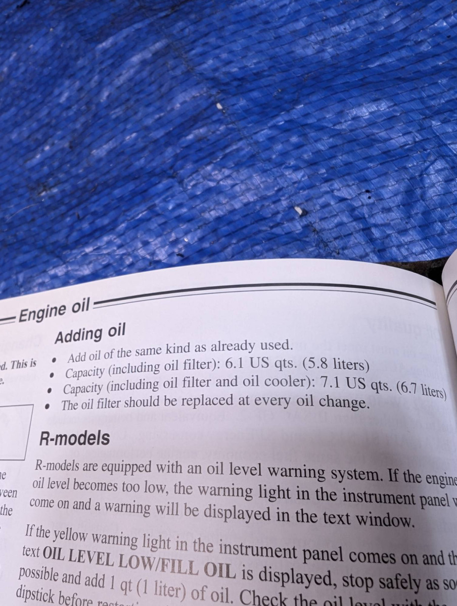

I found another handbook from an 04 XC70 and it has this to say:
I don't believe our car has an oil cooler other than the square box on the back of the oil pan. If that had drained down then is the oi level 6.7 liters in total? Don't all P2 cars in North America have oil coolers or is that only on turbo engines?
Is nothing simple??

Oh, and I left the engine sitting for 5-10 minutes after running before checking level. What I am wondering is if the car should have the 6.7 liters. Still not sure if they mean the rectangular oil cooler unit as the 'oil cooler' in the user guide, or something else?:

Thanks for the info. However, if you saw my copy of the user manual it says oil level is 5.8 liters or 6.7 with the oil cooler.
So today I checked the oil again. The car is slightly nose up due to the floor sloping to the front doors. The dipstick was marginally easier to work with today for some reason. I managed to rotate it so it was almost flat side to side looking from the front of the car, and the markings on the rear face toward the rear of the car. It came out (after wiping first and re-dipping) with the oil only maybe 3mm over the top. Less over than the dealer used to fill it.
Once I had swapped the summer tires on, I put the car back on the ground and got my son to swap the car around so the nose was pointing downward to the front of the garage. After about 30 mins I dipped the oil again and it was still only about 4mm over. So I am estimating I added 4.4 liter jug + approx. 2.4 - 2.5 liters of oil. There was about 2.5 liters left in the 2nd jug.
So total oil added was 6.8 liters (still lower than the dealer typically gives the car back with) as there is a small amount left in the 2nd jug. Based on the amount Volvo advises between the Min and Max I would say that the Max is at 6.7 liters which would gel with the oil quantity including the oil cooler.

First time in 50+ years of working on cars I have ever had this issue. I a now confident that this car must have the oil cooler option as it seems weird that the amount that it takes to get to the top mark looks like 6.7liters. Who knew??
