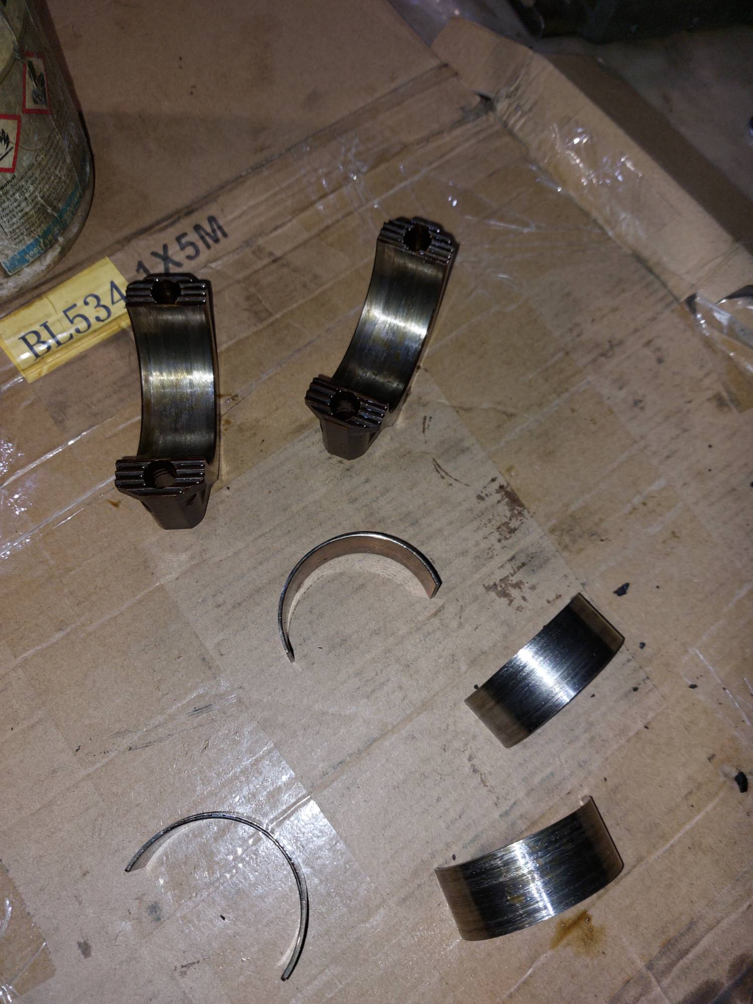

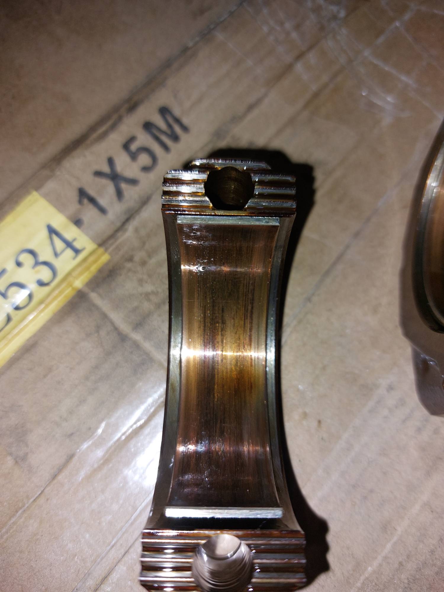

So, theres is some play on cylinder 2 rod bearing...

Can I get away just replacing all rod bearings? What issues there may occur...
