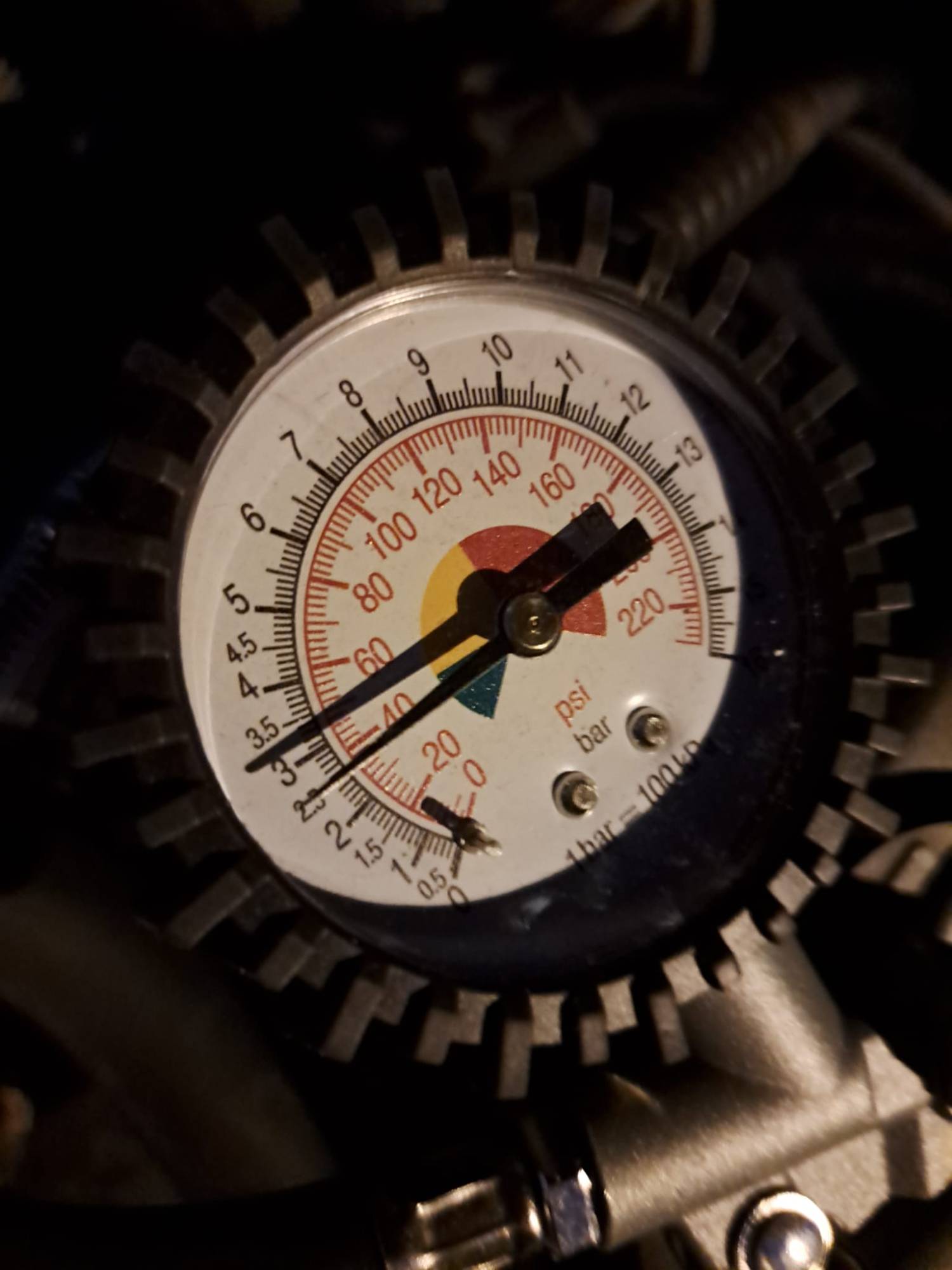

The fuel pressure is around 36 PSI (2.5 bar). Is this perhaps too low?

Too low for ME7 management system. Fuel
Pressure regulation changed in 1999 and the pressure has to be up near 50 psi.
Furl pump relay and pump are suspect.

Again, the 36 psi that Abscate mentions is way too low for a 99 car to run on. 50+ psi is needed. 36 psi is on the marginal side for the -98 cars running with distributors and rotors. I may have read this wrong, you may have meant brake rotors and I may have mis-understood so if that is the case, apologies.

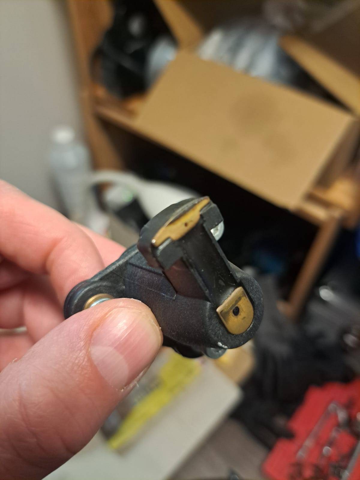

Hello everyone,
Thank you for the quick response.
I don't mean the brake rotors but the part in the picture.

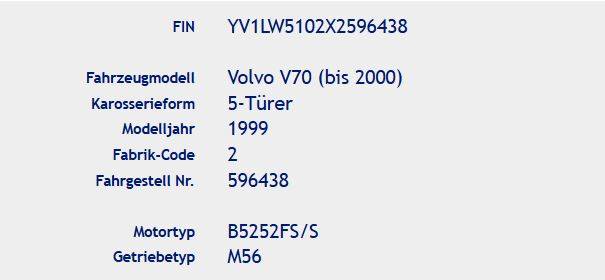

According to the vehicle registration document, the year of manufacture is 1999.
If I enter the VIN at Skandix, 1999 is also displayed.

For 10 Valve thats more like what i have pressure in my 850. But yes that rotor is kaput.

Ok, this is where different markets come into play. We never got the 10 valve engine here in the V/S 70 P80's. So this engine is for us an unknown. However for the guys here, this is a link to that engine specs:
https://mymotorlist.com/engines/volvo/b5252s/
We got 10 valve 850's in Canada, but I believe they were never sold in the US as I understand.
Also we did not get distributor engines after 1998.
So in your car's case, it is likely the same spec as a 98 car with 10V and so the lower 43 psi operating fuel pressure.
I would still look at the fuel pump relay, injector relay on the front above the radiator, especially for broken wires. Fuel pressure is still low.
