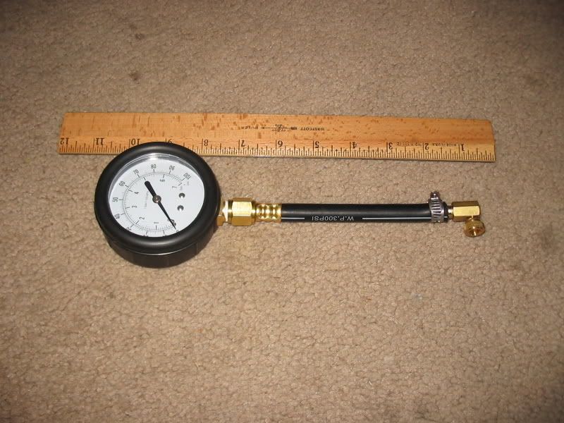

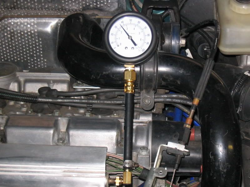

Testing Pressure with a homemade tester: I had a slight leak
