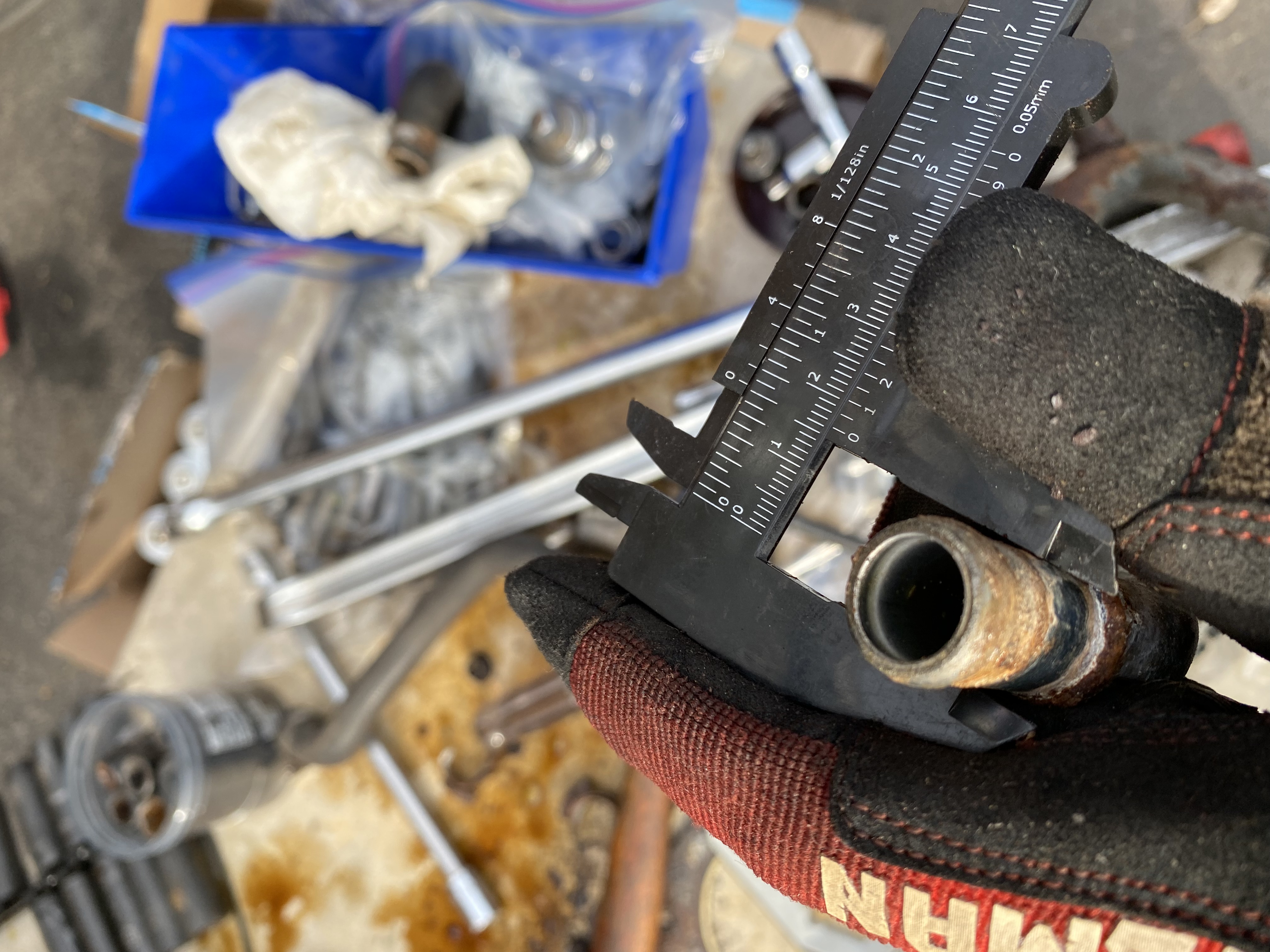

Heater core leaking on 2001 v70 t5
Want to bypass but can’t find ends
Posts: 35331
Has thanked: 1511 times
Been thanked: 3827 times
The heat comes off the rear of the head , left side of car and returns to the water pipe feeding the water pump, down near the turbocharger
Both pipes are 16mm OD with a 17mm step to seal. You can bridge either the hoses removed from the bulkhead or the supply/ return pipe with 5/8 heater hose.
All the flanges on the water pipe are the same in the NA I just harvested. Heater in block, return on pipe, feed for oil cooler, return to reservoir 16 mm OD pipe with a step.
