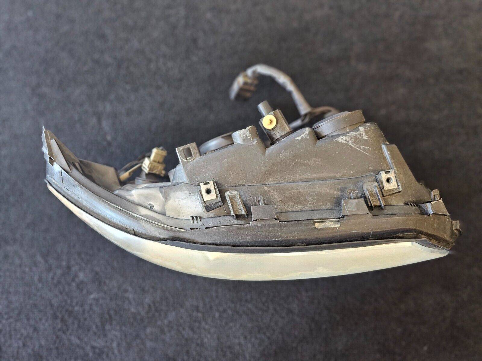

This is the HL assembly that I have (halogen). Photo taken from eBay just to show what I have...

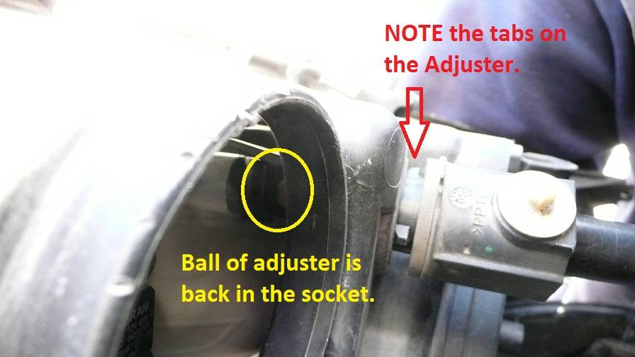

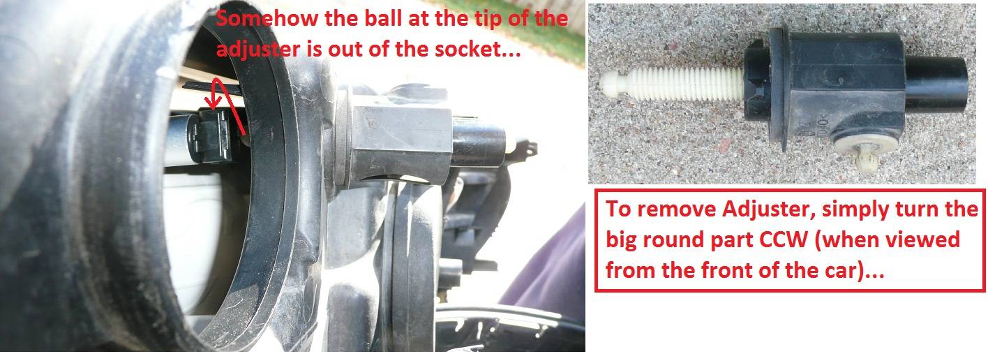

OK,
This is for my 2006 S60 (previous model years have slightly different setup).
For those with HL pointing downward and you cannot adjust it, I have the answer for you.
The ball of the adjuster was out of the socket (the socket used for adjustment on the reflector).
I don't know how it came off, my theory is that: the previous owner/mechanic adjusted UPWARD
way too much and pulled the ball out of the socket, just a theory.
BTW, for the 2006 Volvo S60, when you turn the 6-mm screw on top of the HL assembly:
* CW: pointing DOWN.
* CCW: pointing UP.
I made the "mistake" of removing the HL assembly to see better, but you DON'T have to remove
the HL assembly, you can simply fix this in situ!

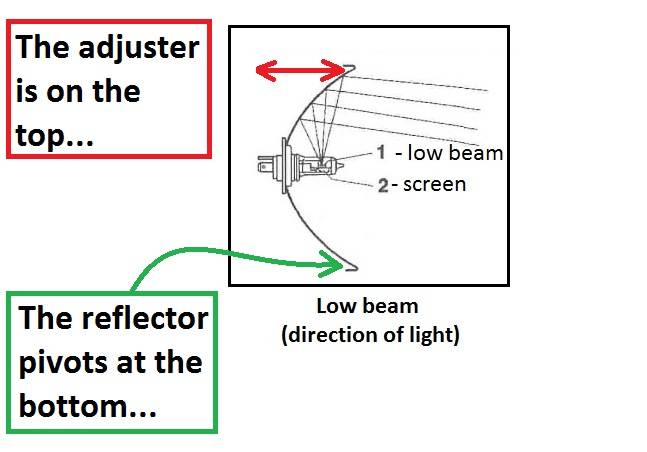

- Most HL works like this: the bottom has a pivot and the top has a socket used for adjustment.
- To remove the adjuster, turn it CCW (when viewed from the front of the car). This is for the RIGHT
HL assembly.
- Now turn the screw on the adjuster so it sticks out as far as possible.
- Now insert the ball of the adjsuter screw in the reflector socket (from the top).
- Once the ball is inside the socket, re-install the Adjuster Mechanism by turning it CW (when viewed
from the FRONT of the car).
- If you are in a hurry and have no time to adjust, just turn the white platic end so it is about 2 mm
INSIDE the black tube (I took the photo with the plastic end sticking OUT, but for proper alignment,
it should be INSIDE the black tube), this should get you close to the ball park.
- Then wait until night time and do proper adjustment using info from the internet: the idea is how
to see far enough WITHOUT blinding drivers in front or from opposite traffic.
Easy fix...
