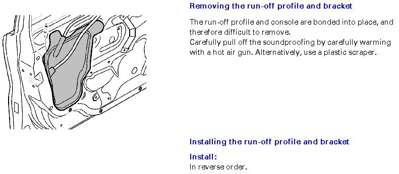

Obviously you'll have to take the glass out, or at least take it loose from the window motor (regulator) and prop it up inside the door frame somehow while you change the regulator out. Below, you'll find the instructions on how to deal with all of the windows in your car...just follow the instructions for your particular window, down to the part that has you disconnect the glass from your regulator. I just replaced the rear door glass in my S70 and yours looks to be much simpler.
V70 window replacement.pdf
(158.78 KiB) Downloaded 533 times
In your case it looks like there are two screws that actually go through the glass (there's a sleeve to protect the glass)...I would say just undo these after taking out the the run-off profile or bracket. and prop the window up and you probably won't even have to undo weather strip material. Below is a diagram for the run-off profile and how to deal with it:
runoff profile and bracket.jpg (55.29 KiB) Viewed 1458 times

I finally got the parts for this and finished it up. Your advice was great. I didn't have to remove the window - just drill the rivets and replace them with bolts/nylocks.
