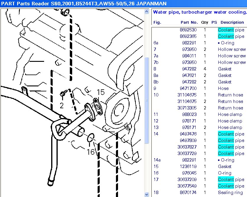

I suspect that #15 gasket is bad and needs replacing and retightening. The part number is located in the right pane of the diagram below. Not sure of the tighening torques and you need to make sure this is the correct place of the leak. If not #15 then 0-ring #16 might be the culprit.

dont think that is it
http://i472.photobucket.com/albums/rr89 ... age045.jpg
no the water is poring out from behind the manifold even when its not cranking and i cant seem to see it. something tells me its a head gasket but there is no oil in it. and no water in the oil what do you think
