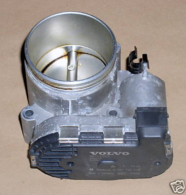

Quite simple: do you have an ETS light on your dashboard? If so, you have the troublesome Magnetti Marelli ETM. To confirm, examine underhood: locate the intake manifold (directly in front of you as you open the hood). To the right of the manifold is the throttle. If it looks like the throttle on this page: http://www.xemodex.com/xemodex_012.htm it's the troublesome throttle.bluey wrote:How do I find out if it has the old ETM fitted?
Note: according to VIDA, both the B5244S and B5244S2 naturally aspirated engines had ETMs through 2004 and part of 2005

OK so I guess I have the bosch unit on mine? There is no ETS light and the throttle module is a lot more compact than the one in the photo. I have not actually taken it off, so I couldn't see a manufacturers name on it to make sure.

And I made a minor mistake--not all P2 cars had an ETS light even if they had a Magnetti Marelli ETM. However, if your throttle looks like the one below, the problem not an ETM problem, as you have a Bosch throttle.bluey wrote:OK so I guess I have the bosch unit on mine? There is no ETS light and the throttle module is a lot more compact than the one in the photo. I have not actually taken it off, so I couldn't see a manufacturers name on it to make sure.
