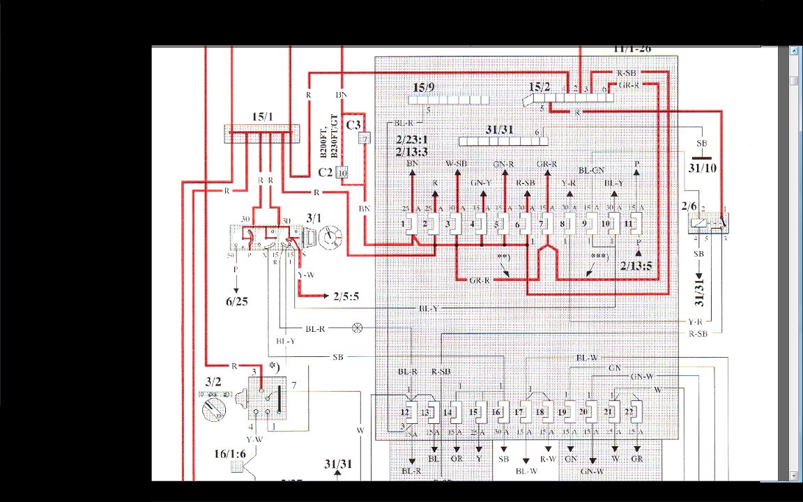

I have a 1994 940 , IS THERE A FUSE FOR THE A/C UNIT..? IF SO WHERE WOULD IT BE ? THANKS IN ADVANCE

Yes, it's #6 in your electrical distribution unit:

#16 also goes to the AC.

It's in the center portion of the dash, in front of the gear shifter.
