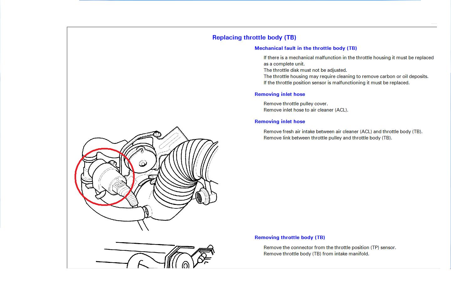

Is this it?
MadeInJapan
- Posts: 13434
- Joined: 31 Mar 2005, 07:14
- Has thanked: 17 times
- Been thanked: 35 times
Yes, that's it...but I believe the '99 is a bit different..there wont' be a connector plug but more of what looks like a grounding wire with an eyelet at the end of the wire (I think)...I would take it off, clean it thoroughly and tighten it back down. With your car's key at position II (not started yet), it should be buzzing, so that's a test for you on that part.
