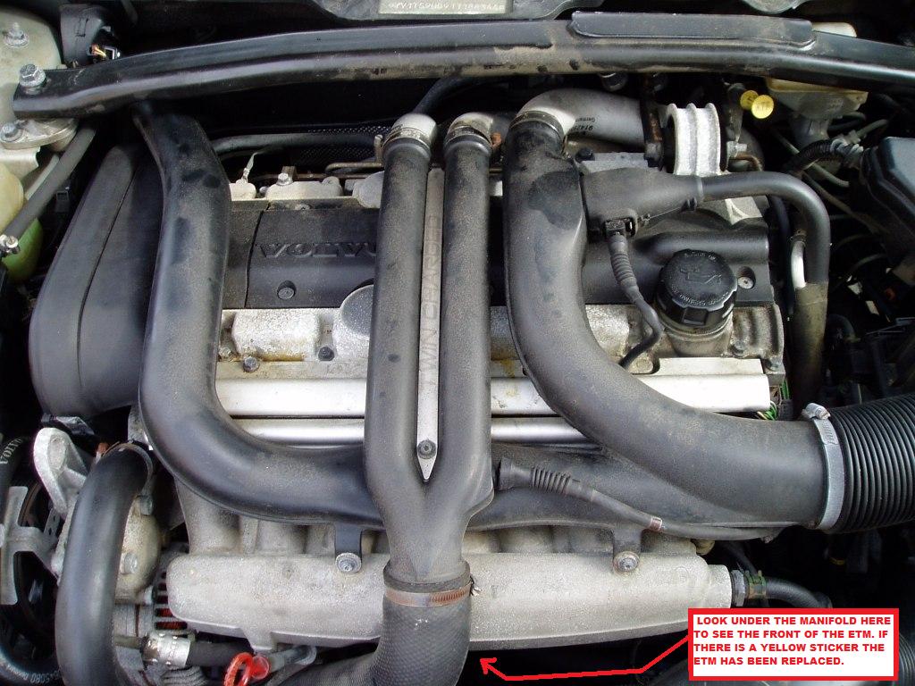

Check to see if the ETM has been changed (should have a yellow sticker on the front if it has). If it hasn't been changed yet, you are looking at doing it in the not too distant future and the extended warranty is about to run out.

vegas, can you somehow show that sticker that indicates the ETM has been changed??? I'd like to check it on my car...

neworleans wrote:vegas, can you somehow show that sticker that indicates the ETM has been changed??? I'd like to check it on my car...

Looked at some pictures, one of the engine.
ETM sticker is white. :shock:
