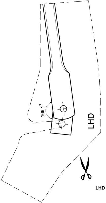

7: Now for the important part. You need to make sure the arms are aligned properly. Print and cut out the pic below. Use this to align the transmission arms. Once they are aligned tighten the nut back up, making sure not to let the arms move from there newly set position.

If the print out above isn't for your car let me know and I can get the appropriate one.
