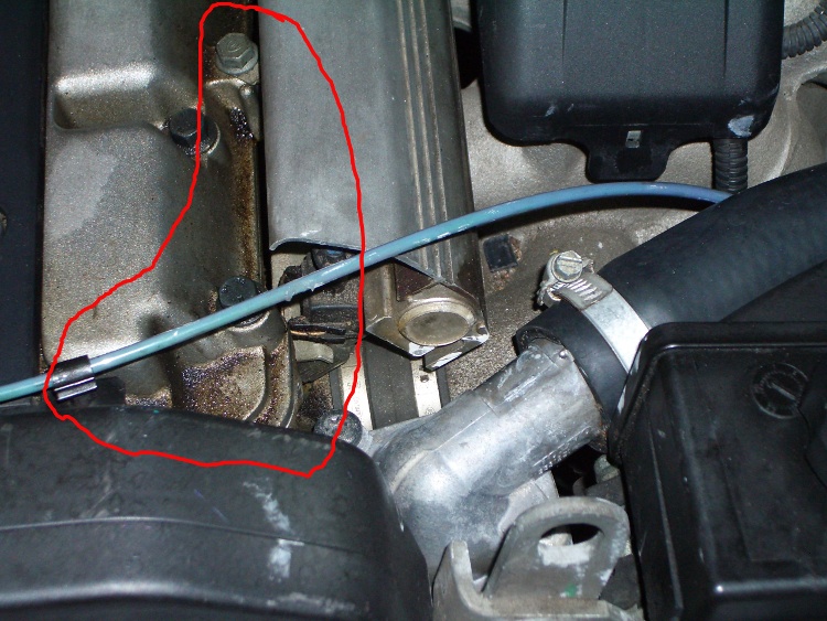

Hello All,
After a successful (and frustrating) timing belt chance I noticed something new. Oil is leaking from both the upper right corners of what I can best call the cam/valve cover. It's the piece of metal that separates the cam from the outer world. It's not the black cover, but the one underneath it.
I'm not sure what I did, but I've included some pics. Might it be a gasket after all?
Could it be oil being blown from the cyclinder one area of the valve cover to the cyclinder six area?
Thanks.
Lee

yea..that is just from the cam/valve cover gasket. replace it and it will be just fine. :wink:

I checked the area near cyclinder 1 several times and noticed that an increasingly larger amount of oil was coming out.
I figured that I had nothing to loose by tightening the bolts, and it turns out that bolt nearest the leak was very loose. So it is possible that was the problem. Oil was being blown from cylinder 1 to cylinder six area after all. I hope that this cures it.
I couldn't find any parts number for a valve cover gasket on any site. So if anyone knows of a place let me know. It could be good practice just to replace it anyways.
I'll keep y'all updated.
Thanks,
Lee

try to tighten the bolt as recomended using torque wrench and clean the oil surface on that area, if lucky you don't need to replace the gasket and helps keeping you budjet :wink:

The valve cover gasket is liquid as is the sump (oil pan) gasket. You can read about it here.

To conclude this thread:
During my haste I accidentally loosened this bolt. It was loose enough for oil to escape under pressure.
I tightened the bolt to the same torque as the others. The leak at cylinder one is cured.
The leak near cylinder 6 was, in fact, oil being blown down the rail by wind.
Thanks to all for their help.
Lee
