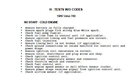

Unfortunately the '89 740 turbo doesn't have the On-Board Diagnostic unit that you can interrogate. It needs a Volvo tool.
Back to basics then. Here is a check list for no start on a cold engine:
