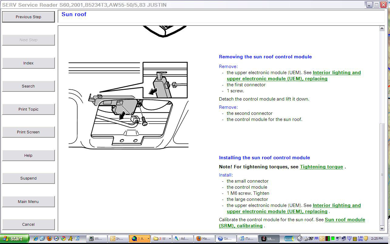

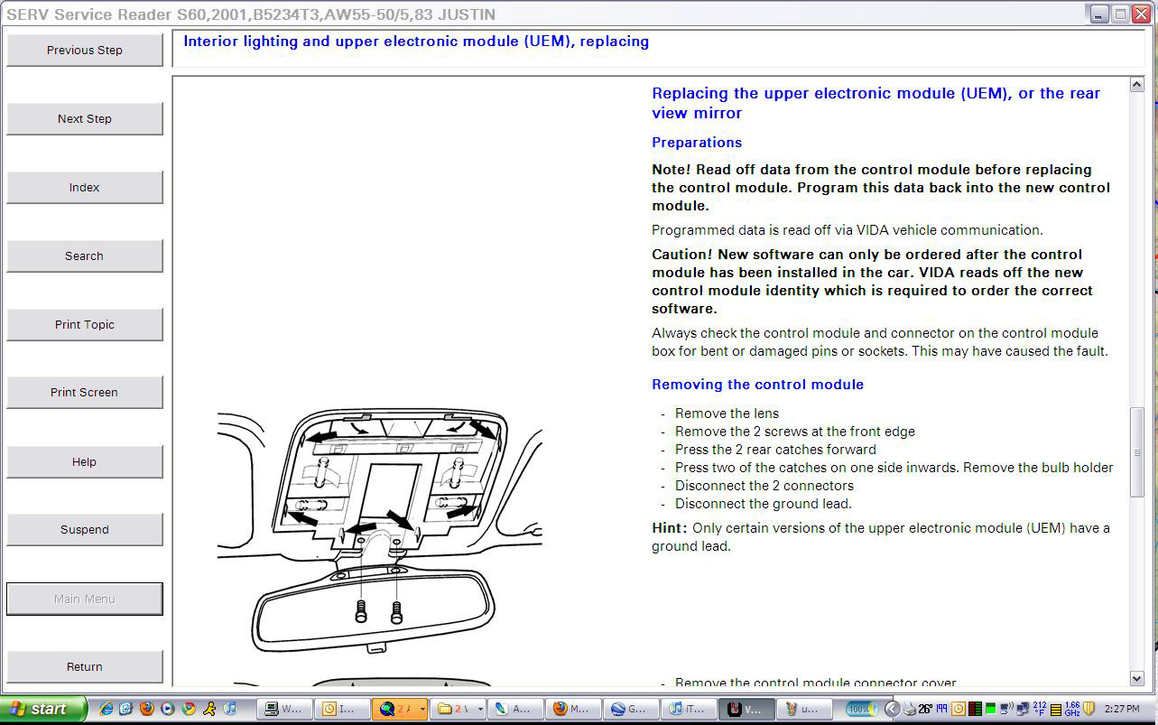

Well, so much for an easy fix...the only thing I can figure is that either there's a bad switch in the module, or the upper module needs to be reprogrammed.
Replacing the sunroof control module can be done yourself, as follows...but the reprogramming is a dealer-only fix, I'm afraid.
Most of me doubts that the motor itself is bad.
