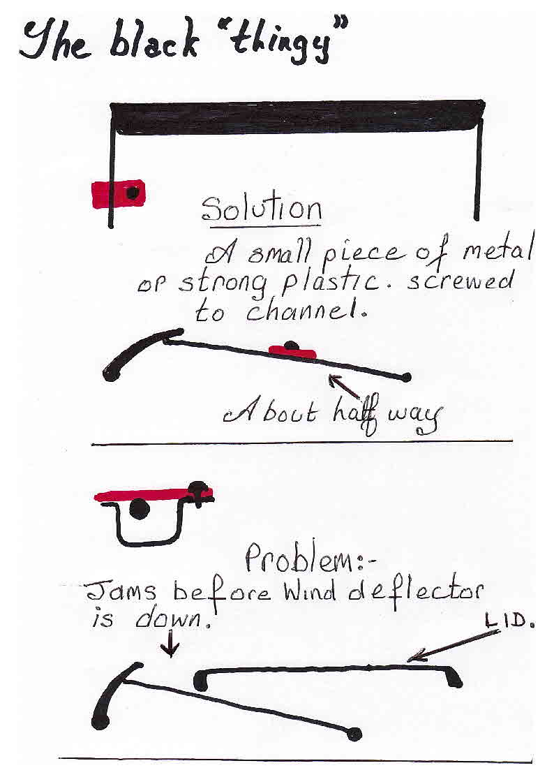

If it's the wind deflector,(blackplastic "thingy" at the front) then this is a common fault,take it off all together and see the result.There is a repair that you can make,fix a small piece of metal or stiff plastic about half way along 1 of the thin rods to stop it lifting all the way up.I'll try and draw it up,and post it.

Ok.Marty,I've had this on every 700,the small operating rods are just not strong enough to survive,and the wind deflector is not closing quick enough before the lid shuts.You can do without it if you wish,if not,then just follow the instructions in the 'scetch'
the black thingy
the black thingy

Thanks to everyone for the solution to the "wind thingy".
However, this seemed to be the least of my roofy problems. As I was examining the rest of my sunroof I noticed some leakage, (actually while giving it a very over-due wash), and that one side of roof was lower than the other.(See previous and newer postings).
So, after all was said and done, I ended up going to the j/y and getting a complete roof unit, including track, for $48. First thing I did was, as advised, was rip the "wind-thingy" totally off of replacement roof!!
