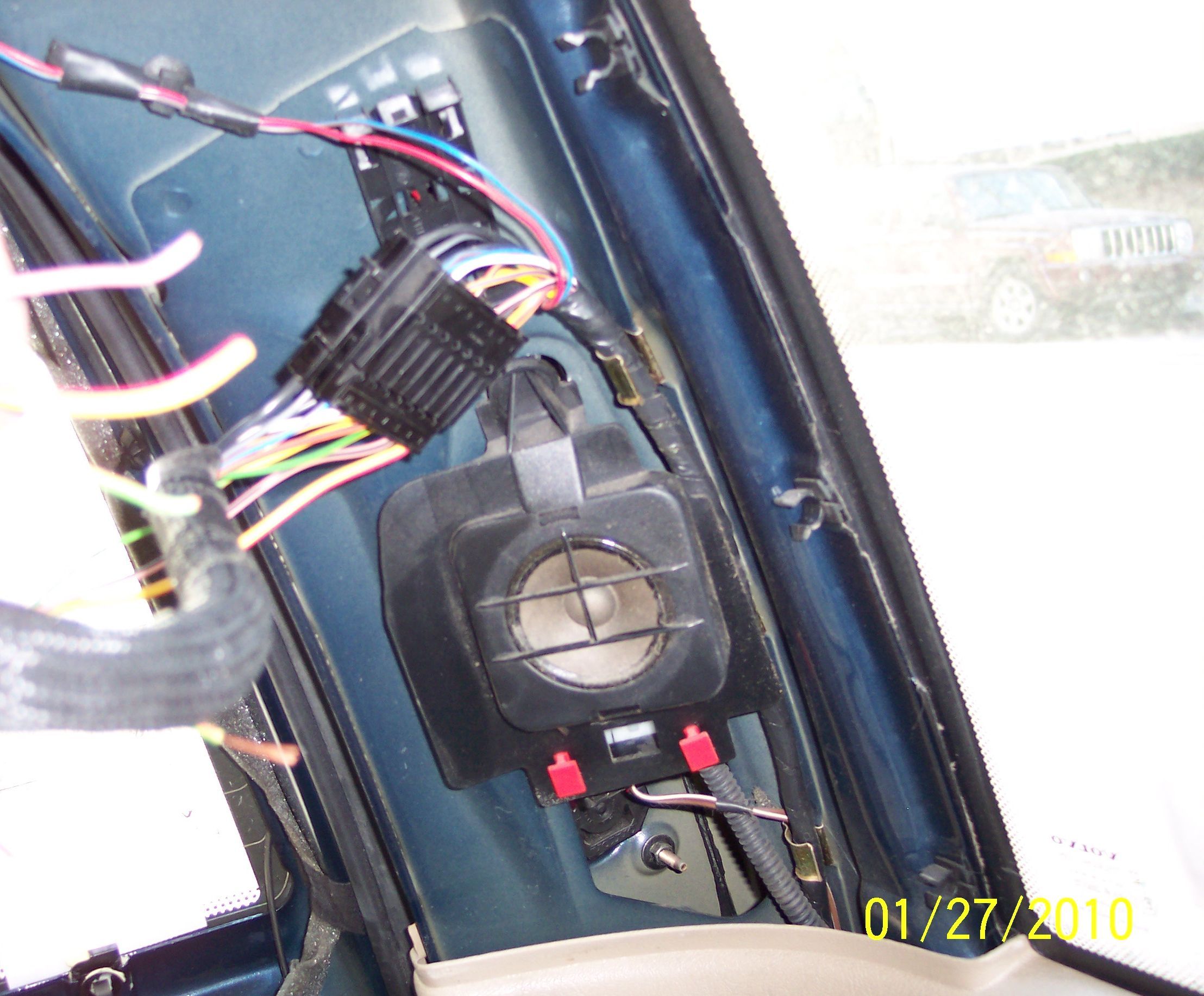

Hey everyone. I discovered my rear wiper stopped working about 6 months ago, and I just haven't had a lot of time to diagnose what the problem could be until recently.
Last week, my rear lock actuator wouldn't lock or unlock the tailgate either, and that's when I had to get to the bottom of this issue.
After taking the actuator apart, dismantling the wiper motor, and breaking my tailgate trim pieces, I've figured it out! IT"S THE WIRING!!! Check the wiring AFTER the rear wiring harness which is located just above the rear speaker(see pics). My situation happened to be 3 wires were cut from the zip tie strap that was factory fastened onto the frame. It was one of the those "ah-ha" moments where you realized all of your frustrations could be solved by 3 butt splices! I hope this post helps someone, because finding this myself certainly saved me a lot of money in fixing the problem.

Ecbsykes,
My tailgate did exactly the same thing for both the rear wiper and the rear locking actuator, so I'd be willing to guess that if you were to look in the same spot I did, you might find the culprit.
As for that trim panel...
I'm not going to take pictures(too cold here today!) but I think it is fairly simple enough to explain what I did.
1. Look @ the drivers side rear speaker. Do you see the two little 'indents' (i'll call them indents I guess) on the left side of the speaker surround? OK, now get a smaller flat-head screwdriver or a 5-in-1 painters tool(what I used) to pry the speaker surround open. That piece is held in place by a 'snap connector' (again, I just am calling it that). Once off, study what those connectors look like because the rest of the trim pieces are held together by the same stuff.
2. There is 1 torx screw up by that little hook thingy on the drivers side that will need to come out.
3. Pry open the little rectangle piece on the trim section that is located above the back seat head rest. Might want to use a painters tool or something with a sharp edge for that.
4. Now you are ready to CAREFULLY remove the whole trim piece. I was able to kind of forcefully pull on this piece on a cold day without it breaking so you shouldn't have to worry too much---just be careful. Remember those snap connectors? That is what kind of resistance you are up against, so first pull the section closest to the back seat, then work your way towards the tailgate.
5. Assuming the trim piece is removed, you will have to study the area where the wiring harness is and look at where the bundle of wires travel. Do you see where the wires travel on that curved piece that moves with the tailgate? It is covered by a 'sleeve' or protective jacket that you might have to remove, along with some black electrical tape.
6. Now check that zip tie location---the location that my finger is pointing to in the above picture. Slide that sleeve away and you possibly will find your cut wires.
7. If that is the case, get some 'butt-splice' connectors, strip the wires appropriately, slide the connectors together, crimp them with approved tool, and test it.
I hope you can follow how I worded this, and if it's still kinda hazy, let me know. I'll take some pictures.

BINGO!
I am so thrilled right now! I followed your instructions to the mark (and am actually quite disappointed that I couldn't figure out the panel removing myself!), and there it was... a little black wire cut straight in half!
That one definitely will be spliced, but I'm also a little worried about some of the others. None are broken like the black wire, but the plastic insulation looks brittle and weak. Might do some preventative maintenance splicing on a few.
Thank you so much for the instructions! I had pretty much given up hope on my wiper working again. Figured it would be some super expensive electrical rewiring.
I LOVE this site!
I LOVE this site!
