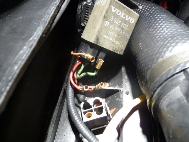

I think I found one possible problem with this connector. Problem is I need to know how to wire it. Can someone please pin the colors so I can wire it back. It is easily accessible on top of the radiator. First one to help gets free beer for life!!

The schematics show
Pin 1 - Orange/Black
Pin 2 - Red
Pin 3 - Green
Pin 4 - Red.
Your yellow wire is not shown of the schematics but I would run it to pin 2 to try things out. If that doesn't work swap the red and the yellow between pins 2 and 4.
...Lee

Thanks Lee. It was the connector. After I hooked it up it started right up but was idling rouge. Found another connector off that goes to the air cleaner box and it that fixed the bad idle. Then it was test drive time to see how the turbo was working. It had full boost but then all of a sudden lost boost and started to idle rough again. Drove back to the house and found out the hose going to the idle control blew off since I forgot to put a clamp on it. Now it runs great has full boost and was well worth the $1200 of parts and a few days work. Plus my 14 yr old son now knows a bit about his future car and how to maintain it.
