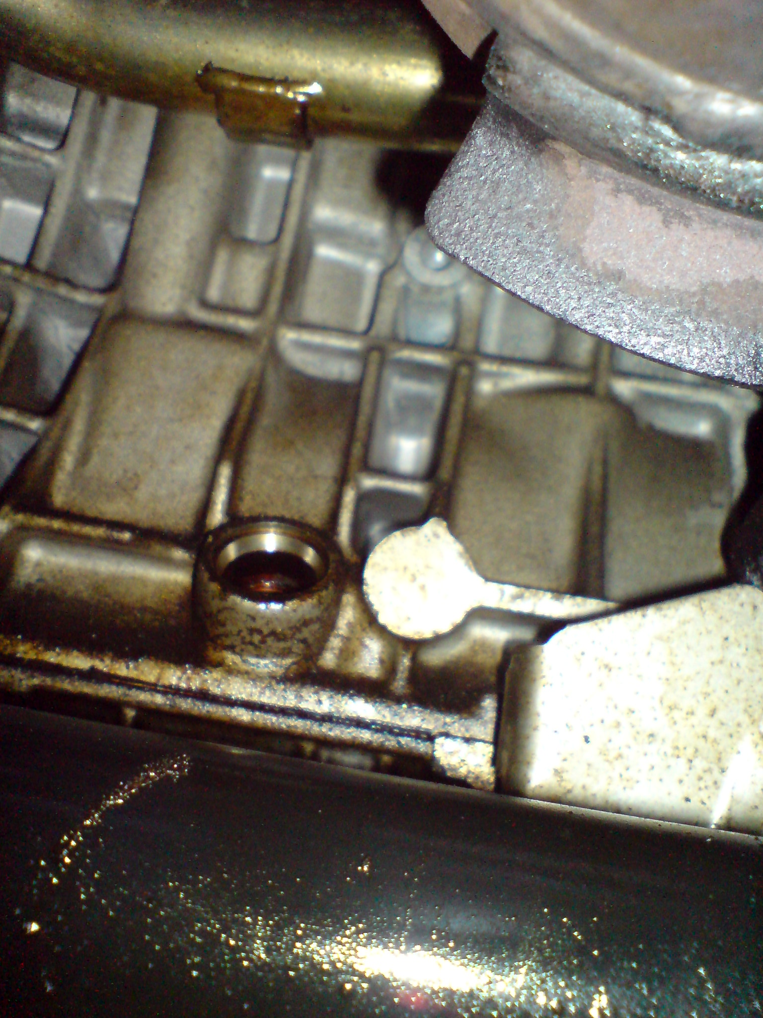

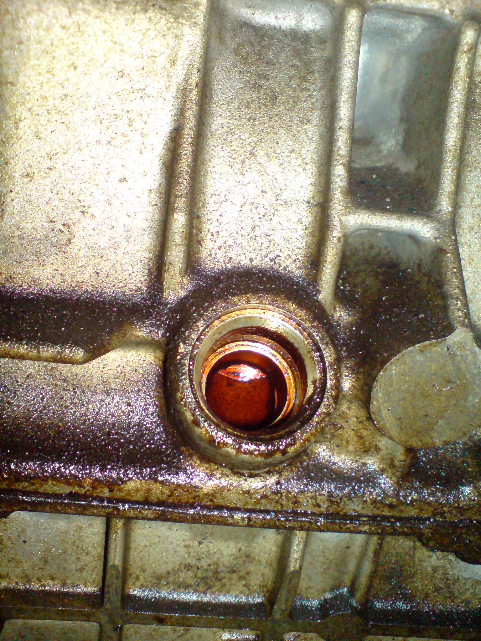

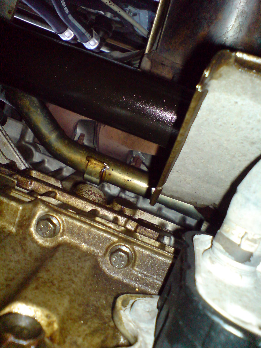

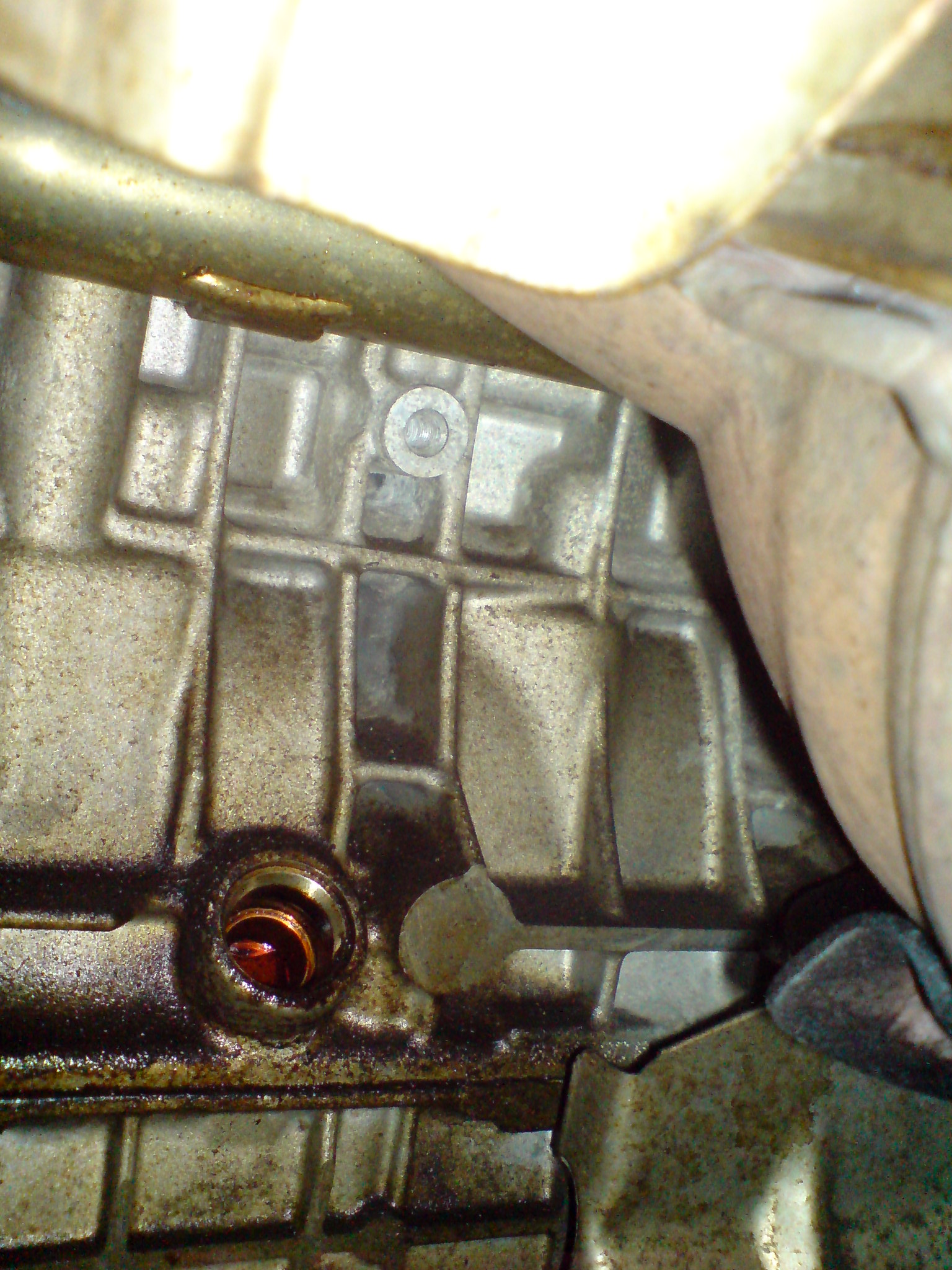

heres a few pics if anyone can decypher.

Post by JDS60R »
Looks like part 20

Post by toots1 »
you're 100% right.Went to the dealers today,its part 20 alright.Its a turbo pipe connection,but without a turbo its simply plugged,so part is on order hopefully there isnt a more serious reason why it blew out the plug in the first place many thanks to all who helped me out on this.
