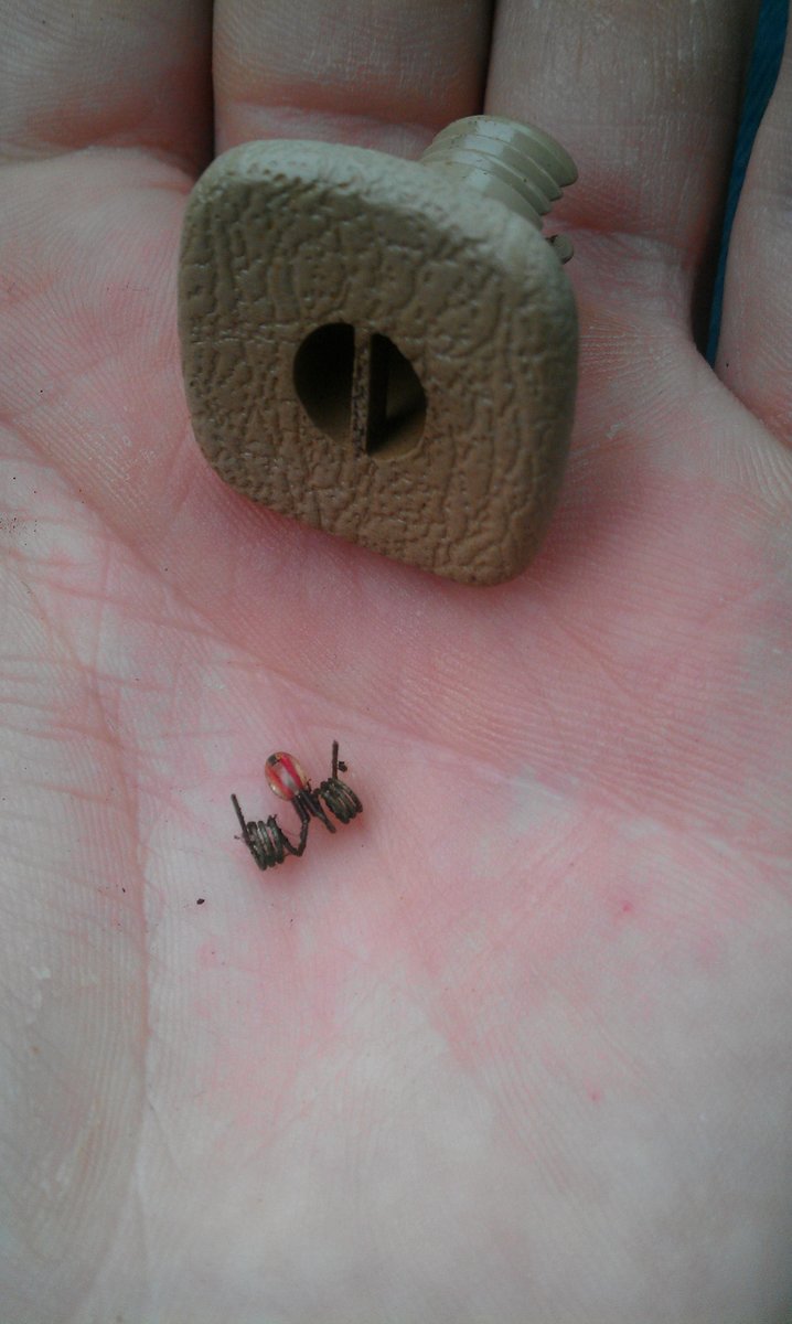

Post by hanzbe420 »
hi the spring fell out of my sensor! If u look at the pic here,
is there anyway i can just put it back in? it didn't look broken. Just looked like it fell out.. Here is my post about it. please answer there if u can, because my blower motor stopped working and gave a power stage code then 1 day it just turned on but still flashing the lights. so i looked up the code and got 124 and 126 interior temp sensors. But my question is, If the powerstage died and threw a code, how come it is working now? And why did the sensors go? My blower motor makes allot of noise and needs to be changed would this cause resistance and blow the sensor maybe? But i can't clear these codes. It says i clear them but then i press it right after and the code is there so im wondering if i should just go to the junkyard get a blower motor and 2 temp sensors, even know i think its just the driver's side that broke cause thats where the spring fell out. plz help!

Post by flatogen »
hanzbe420 wrote:hi the spring fell out of my sensor...
That's not a spring. That is the thermistor, the heart of the sensor. It looks like a spring because the leads, the wires connected to it, are coiled so as to have a lot of contact with the air being sucked by it.
Mine also fell out, but I can't find it. I need to get a 10k ohm NTC thermistor and solder it in. See this thread:
http://www.volvoforums.org.uk/archive/i ... 22093.html
But I don't know how to get the assembly out yet. Anyone?
