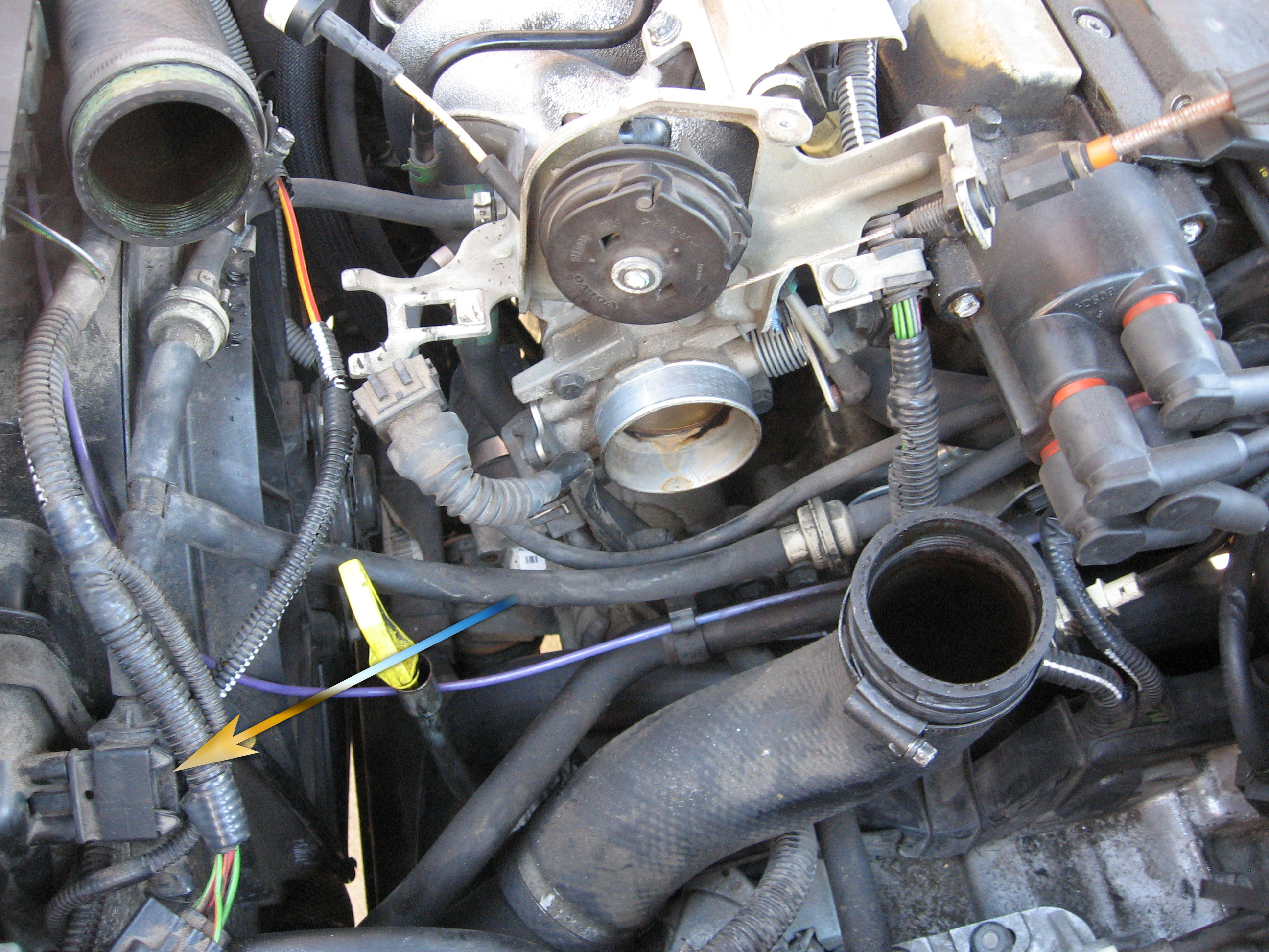

where is the purge solenoid located? i thought i replace it, but apparently it was the air pump solenoid

Left corner of the radiator.
See it hiding there at the bottom left of the picture?
Disconnect the line into the intake manifold and go for a quick drive; do you still get stumbling like crazy? If that solves your problem, please reconnect the line or plug it up with something until you can get a new valve. Gas fumes from the line in a hot engine compartment are asking for disaster.

To the left of the "T" is where I'm looking, right? I will have to investigate that. Thanks for the tip!

You know, as much as I use Photoshop at work, I avoid it like the plague once I get home.
Here you go, I've been meaning to put an arrow on this picture for some time now.

thanks, going outside to check it out

just changed the valve. i'll report back in a week if there's no CEL
