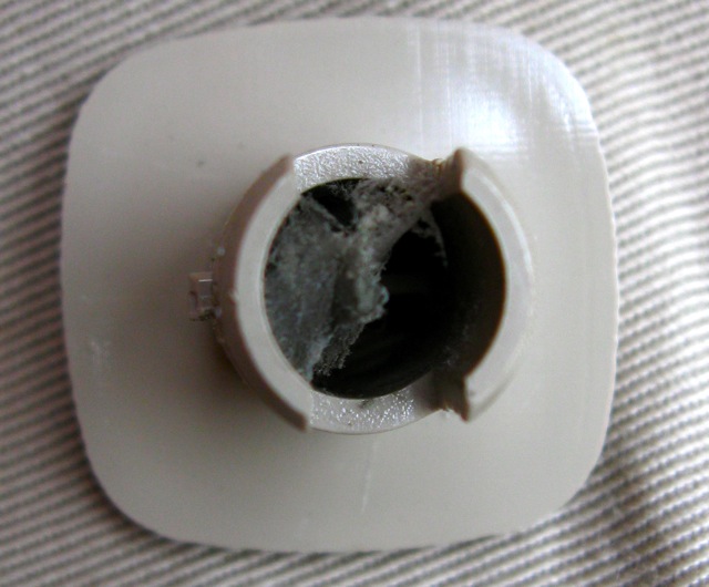

Check the grille for dust too. One of mine was packed:
The grille was full of dust too.

On my 855, the plastic grilles pull straight out with just a small amount of force. No need to pry or pull to the sides. They're held in place with a little lip of plastic and you just grasp the sides and pull out.
I tried blowing the dust away first to avoid risk to the wires from touching with a brush, but I couldn't get any of the dust to come off. So, I used a fine tipped brush (an old art brush or touch up brush) and gently brushed away the dust. Then I blew air and removed what the brush had loosened up.
