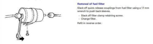

Take a look at this. It is the same for the 940 and 960.
The lines to and from the filter are held on by quick release connectors. The easiest way to get them loose is to lever them with a 17mm open ended spanner:
Bill.

The filter & main pump are located under the driver's seat in the USA or passenger seat in OZ and Britain. There are four cage bolts through rubber grommets to remove and afew bolts/brackets. FCP groton has the pumps and filters for your car.
