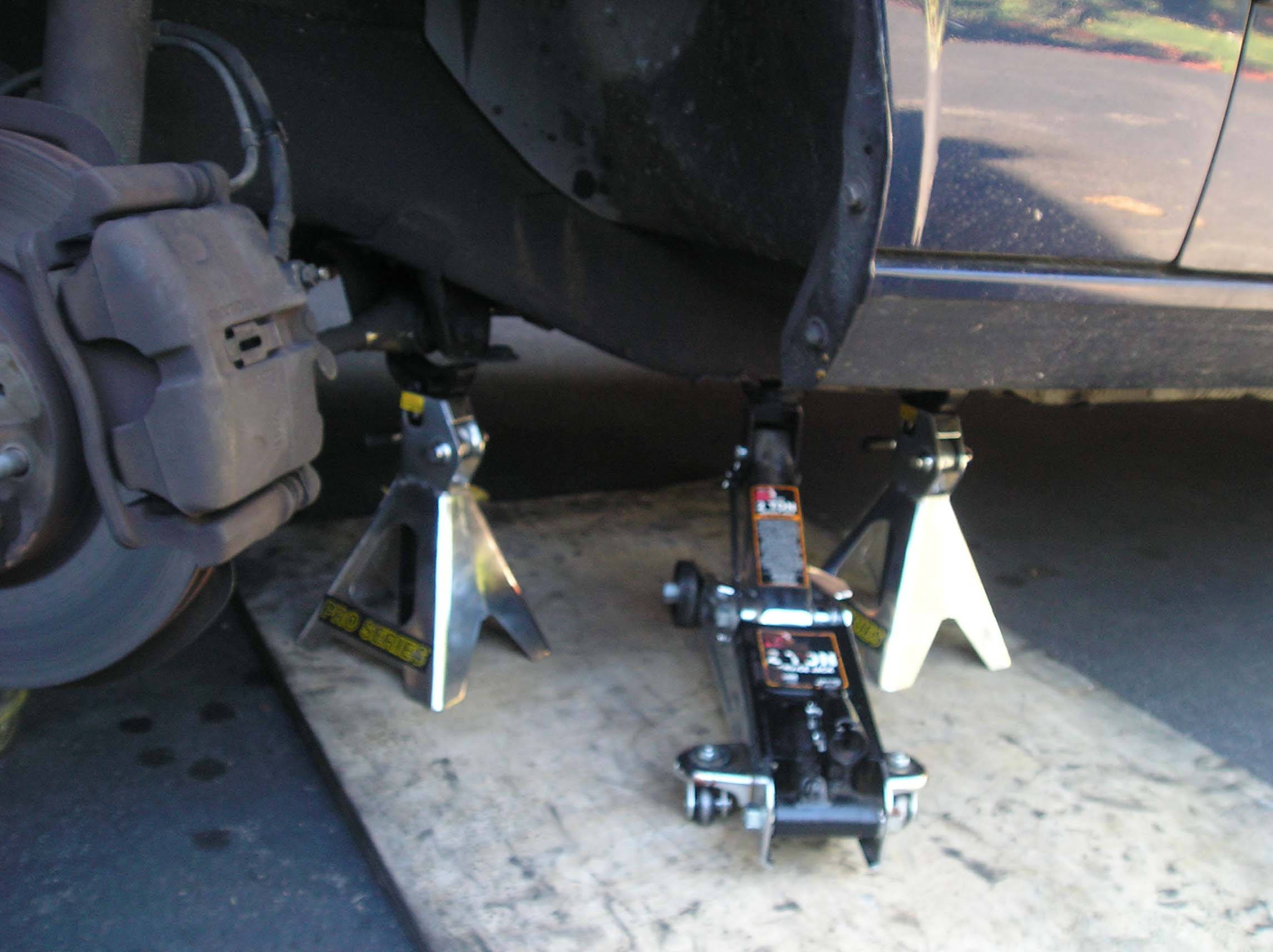

1. First, practice safety. Park the car a level surface with the front wheel turned away from the side on which you will be working. Place into the park, and engage the emergency brake. Chock both rear wheels. As the front wheel was turned sideways, I also chocked the opposite front wheel to prevent rolling. I carefully jacked the car, watching the position of the jack on the frame as I raised the car. When in place, I lowered the car onto a securely placed jackstand, and use a second jackstand as well as the jack itself as a backup. Before I started work, I did a linebacker shove into the car to ensure it was sturdily placed.

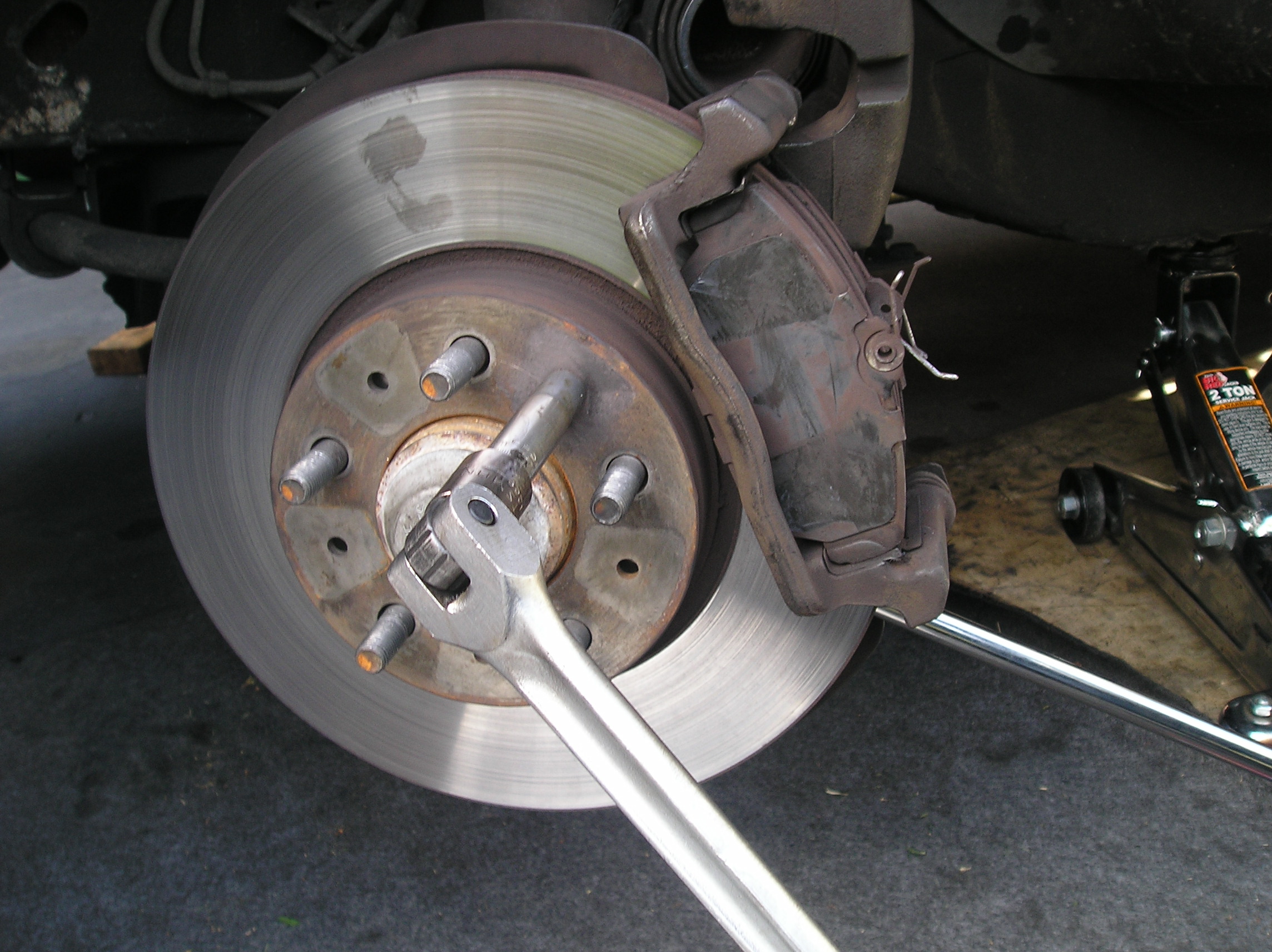

2. Remove the road wheel. What I thought worked best was to use the breaker bar to break loose the caliber guide pins, the hex caliper bracket bolts, and the rotor alignment pin. (Jam a socket extension into the rotor in order to immobilize it in order to remove it.) Now is a good time to double check that your replacement parts will actually fit.

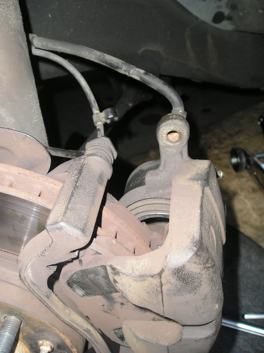

3. Remove the caliber guide bolts. (I always recommend wearing safety glasses, and now is a good time to put on your dust mask.) Lift the caliper off the caliper bracket; use your piece of wire to securely hang it from the spring.
4. Now is a good time to use the piston compressor tool to push back the caliper piston. Before doing so, ensure that your brake fluid is at the minimum level, and loosen the reservoir cap. To avoid pushing dirty fluid back in the system, open the bleed screw one turn with the catch bottle affixed. When the piston is flush, close the bleed screw. Use Brakleen and a clean rag to ensure piston is clean.

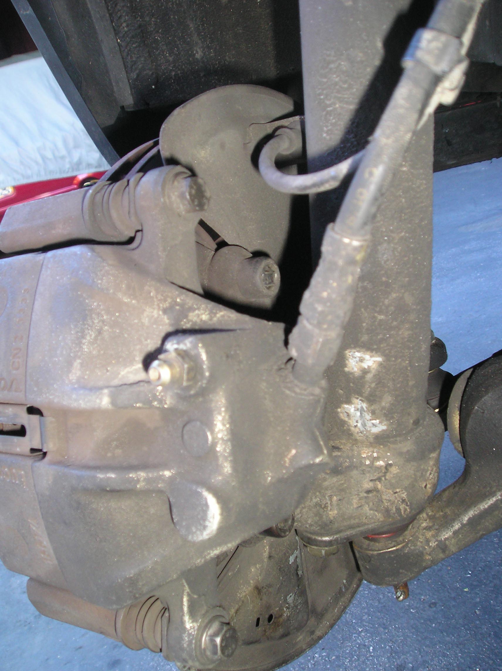

5. Use the hex head socket to remove the caliber mounting bracket.

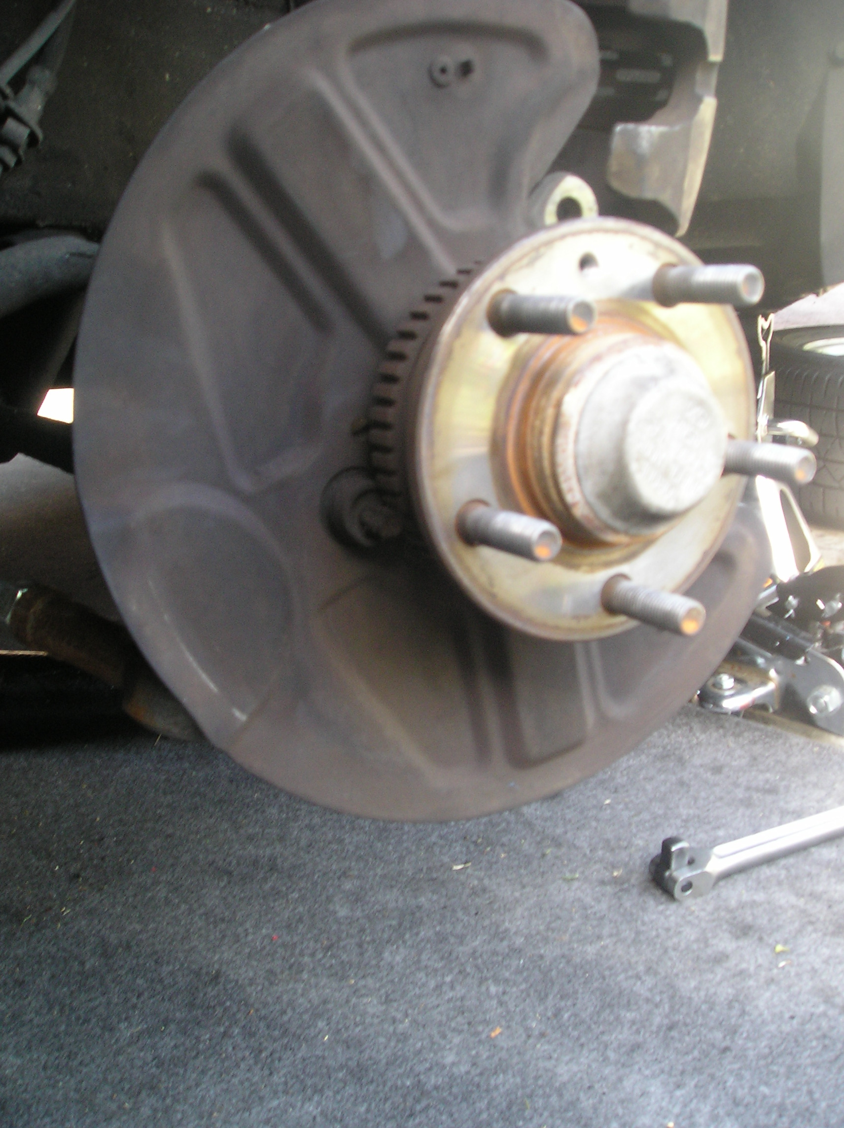

6. Remove the rotor alignment pin. Remove the old rotor.
7. Use your old paintbrush to carefully remove the dust from the ABS sensor. There will be a fair amount of it. Obviously, take care not to breathe it.

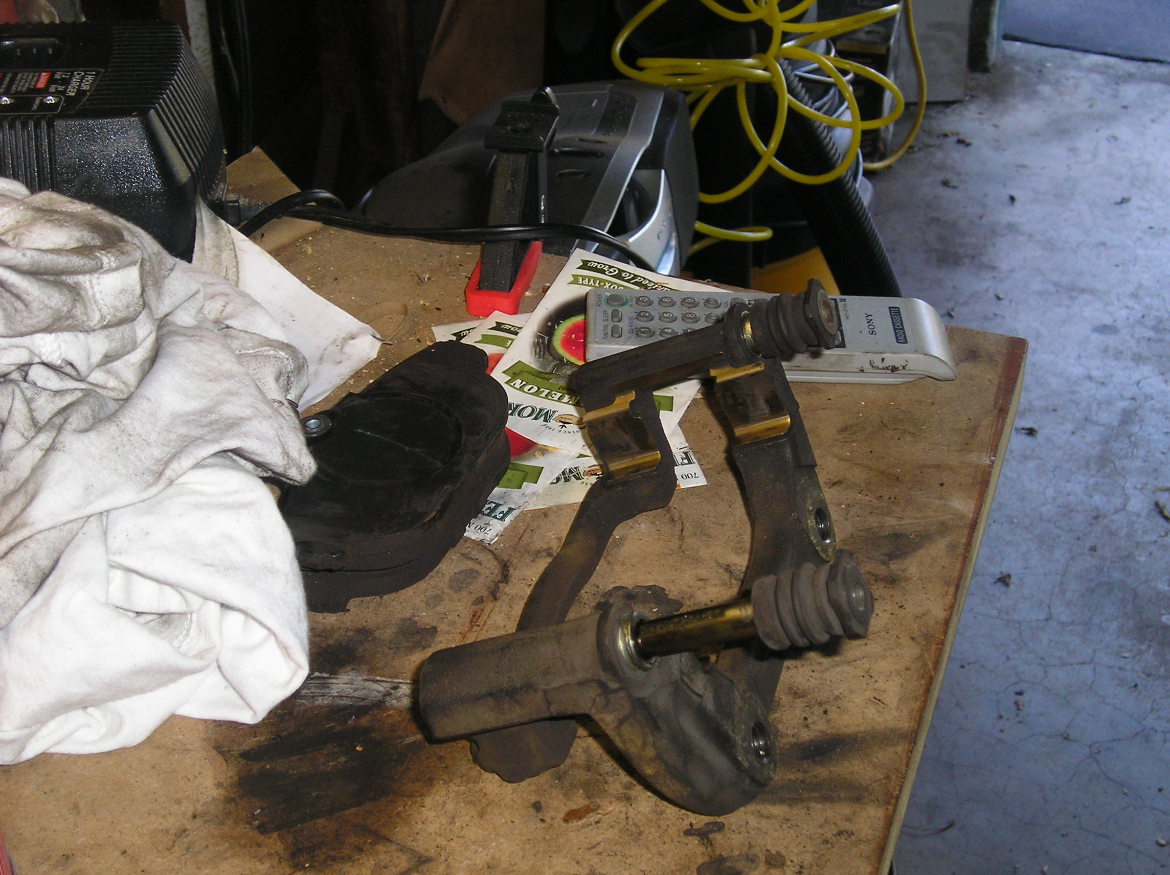

8. If you have a workbench, use the Brakleen to clean the shim area on the caliber mounting bracket. Remove the caliper pins and dust boots. Inspect, clean, and if acceptable, regrease and re install. Carefully regrease the shim are on the bracket. Set aside.
