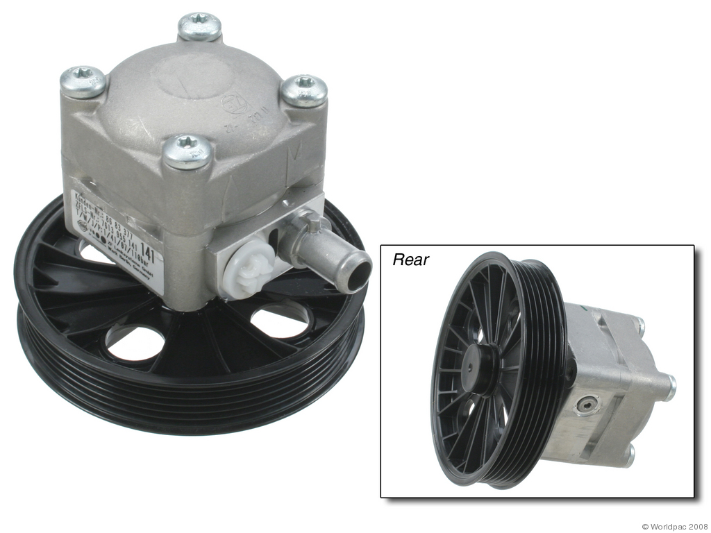

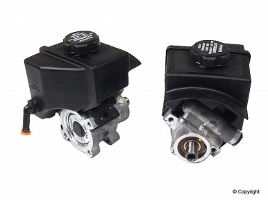

If your PS was using PS fluid previously, you dont want mix w/ ATF. As I recalled Volvo switched to use PS fluid somewhere in 1999/2000 model year due to different PS pumps were used (ZF pumps). Is your reservoir sits by itself or on top of PS pump? If yours is sits by itself, most likely you have a ZF pump.

I found pics for these two different pumps.
the one with reservoir on top:
ps pump 98.JPG (29.26 KiB) Viewed 3929 times
separate reservoir:
ps pump 2000.jpg (321 KiB) Viewed 3930 times

My fluid reservoir does not look like those in pictures. Rather, I have something look like the one in the next picture. Does that mean ATF is still correct fluid but somehow previous owner used wrong fluid? I will probably let it idle for a while and if it gets worse, I will try flush more fluid out. Or maybe I should just flush with PS fluid? I will 'Never touch something that is working fine.
