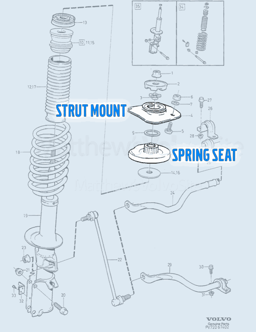

Hi all, so my girlfriend has the 1999 S70 2.4 non turb vin 55, it's making a creaking noise from the front left when going over bumps or if you simply push up and down on the front of the car.
Local Volvo shop (not dealer) says its the "strut cap" which I know as a strut mount plate/bearing, I called a dealership to see how much for parts to do it my self as I couldn't find them at local stores in stock and the guy who answered the phone in parts said it was probably the spring seat, without me even asking.

Is this actually whats causing the noise?

Easy way to find out.
Turn the car on, have her turn the wheel.
YOU watch the strut mount, and see.
if it makes noises then its the strut mount. easiest and free way to do it.

Tried it and it doesn't make any noise when its turning, just when its going up and down.

Spring seat... common issue that we've all replaced.

Probably the spring seat and that one is not the one to buy
Either buy an OEM Volvo XC90 spring seat (it fits) or IPD's HD (their own) spring seat
Do not consider any others
