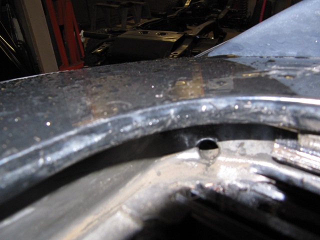

OK, thanks. I took some pics after vacuuming up the water. The two floor board shots show what is there, there aren't any real kick panels down there. I believe the other to be the moon roof drain, I put some air down this hole and heard air coming out from what I believe was under the car. I saw no water entering the floor area when I did this. Also the air intake at the cowl is clear and the cowl drains at the corners of the cowl are clear as well.

Moonroof drain
Moonroof drain
