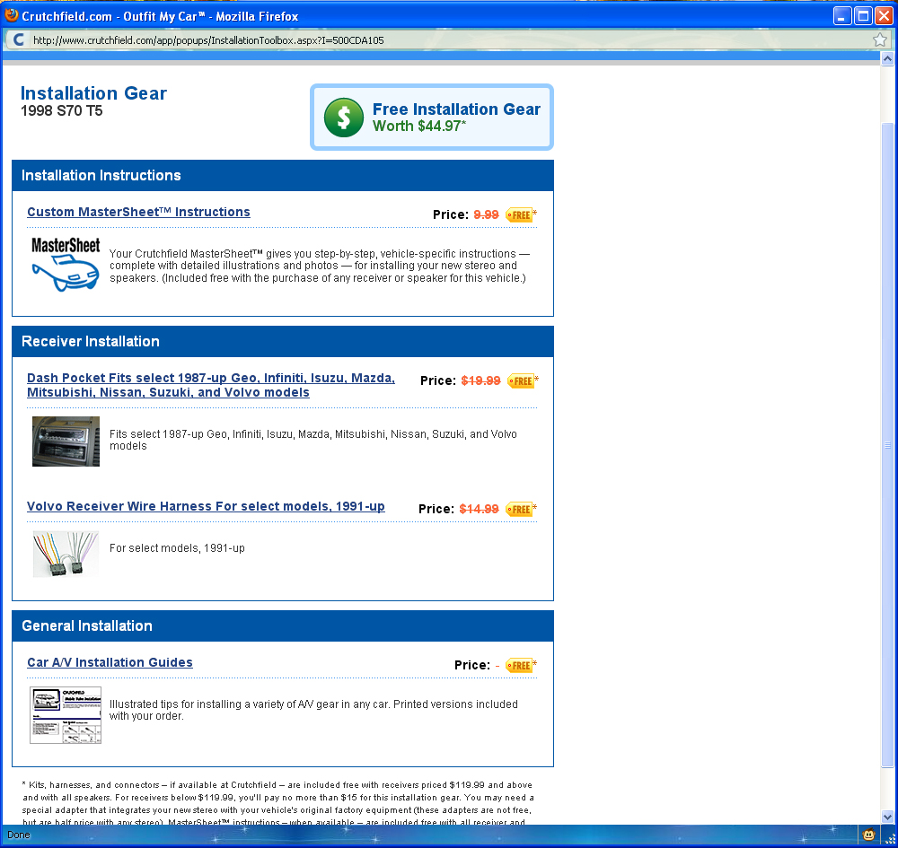

Whatever you do, PLEASE BUY A HARNESS and don't cut and splice things. It makes it a huge mess for owners to figure out afterwards.
The tape player/iPhone method works just fine for me :mrgreen:
I've always liked Alpines if you want to go aftermarket, though.
http://www.crutchfield.com/s_500CDA105/ ... and|Alpine
The cubby is called a "dash pocket"
