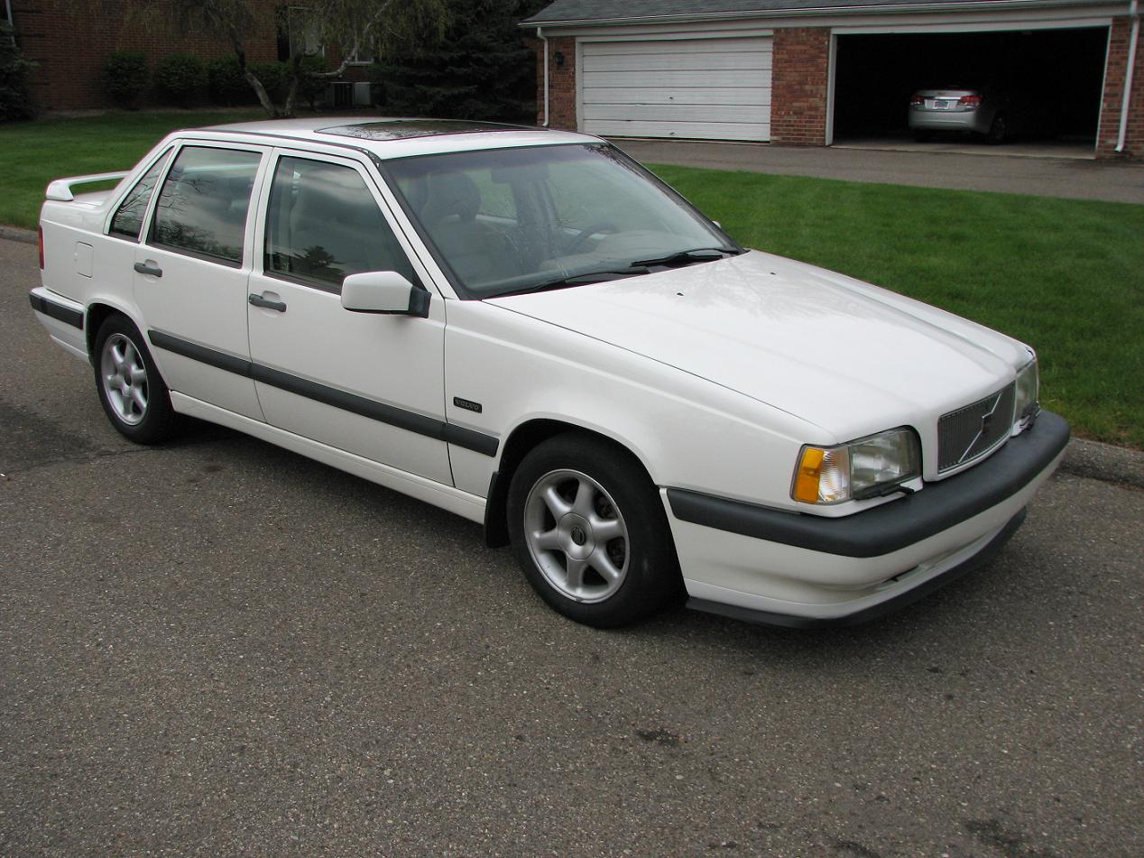

Here is an update on the repair.
I replaced all the above mentioned parts and everything seems to be working. the only thing I had to search for was an adapter for the clockspring connector to the SRS harness. 1993 850s can be a pain in some unexpected places. It seems they completely changed the harness connections everywhere on the car in 1994. From the headlights and corner lights down to the headlight wiper motors.
So what I did was replace the '93 bumper with a '96. I also changed out the door moldings from the thinner Alter 1 style.
I left the large Alter 1 headlights and corner lights, I like the look better.
I added a rubber lip to the spoiler area for a little something extra. Altogether I like the new combined look, old and new. The rear bumper is still Alter 1 but I also like the less bulky style.
Just before the accident
Today in the same parking space
comparison view.jpg (18.34 KiB) Viewed 2868 times
Mix of old and new.
Mix of old and new.
