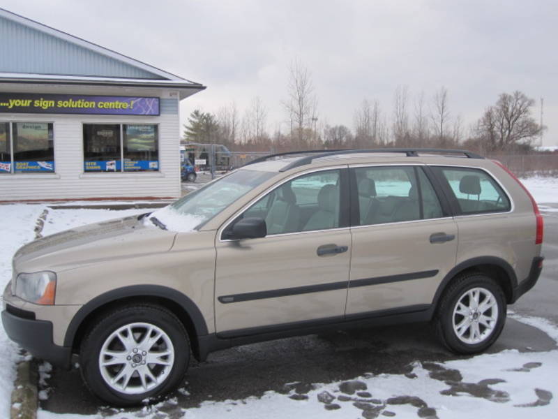

So I sold my beloved 99 V70 t5 SE yesterday and immediately went and saw this xc90. Wish I could have kept the V70 but insurance is super crazy here in Toronto especially if you have 2 cars.
Anyways, the xc90 is 2004 2.5T. It drove nice and has brand new Firestone tires on it. Brand new brakes. The mileage although slightly to the higher side, 220,000kms (approx 137k miles) on it but the car was clean. small dent on the passenger door which i will get taken care of with PDR.
First things first, I wasnt able to track down whether the timing belt was replaced or not, so that will be first thing to check/replace when the truck is delivered to me. At the same time I will clean the PCV hoses behind the power steering pump. Aside from that, I cant seem to find the transmission dip stick?!?
Cosmetically I will get the windows tinted down the line as well as renew the headlight lenses because they are fogged up.
I was told that this is the entry level of this model (ie no power folding mirrors) Not sure what else is not included options wise. I bought it because it drove nice and was clean.
Any advices would be welcomed greatly.
