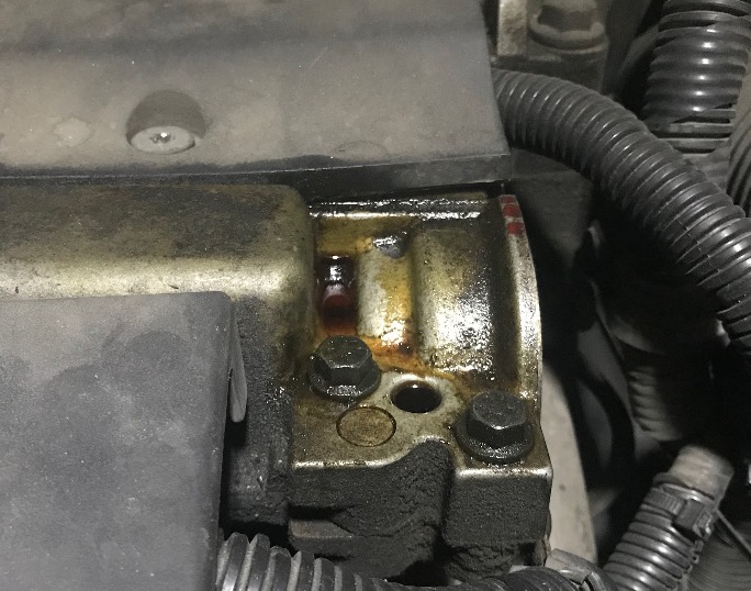

What's the reason for this oil deposit?
Thanks.
Oil Deposit On Engine

As above, see/replace that gasket, then undo the torx screws from the cover and check the hose near the oil cap for leaks/cracks (would be a pcv system). If the pcv was never done, replace it at this moment.
