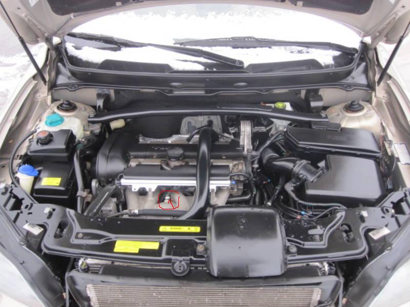

The small hose that connects to the middle top of the intake manifold.what is the purpose of this hose? is it related to the pcv? Its on a 04 xc90 2.5t.
And is the PCV similar to the 99+ V70s with the banjo fitting behind the alternator?

No, it is not.
Use the link to ipdusa at the top, you can see an image of the kit for your car there.

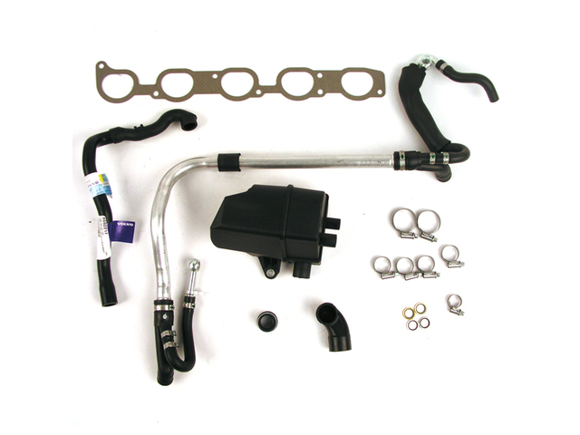

Here is the photo from IPD USA. I dont see any hose that would go there. Any help? Thanks.

Here it goes, please see the attached diagram.
Here is an excellent DIY write-up on how to replace your PCV system:
https://www.matthewsvolvosite.com/forums ... =1&t=28487
It is much better than what is in VADIS :D
Sorry for the confusion; the tube marked on your picture appears to be either the evap hose or a fuel line, not a PCV component
XC90 PCV Parts.pdf
2004 XC90 PCV System
(49.58 KiB) Downloaded 130 times
