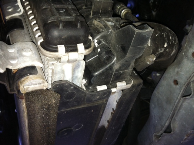

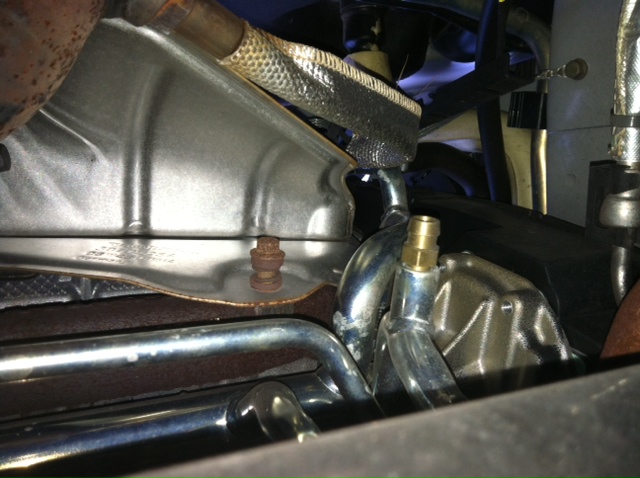

Post by re_buchanan »
I've attached a couple of images showing what I'm guessing are the block petcock (brass valve? in the middle right of 1st image) and the radiator petcock (center of 2nd image)
radiator petcock.jpg (118.19 KiB) Viewed 3192 times
block petcock.jpg (119.38 KiB) Viewed 3192 times

Post by regent »
Exactly.

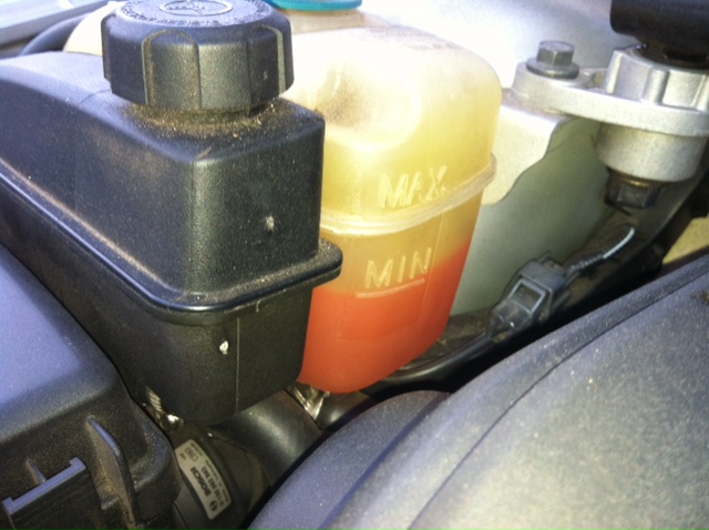

Here's a pic of the coolant that is currently in my car.
Before I have this conversation with my insurance company, can someone confirm that Volvo has never used an orange coolant?
orange coolant.jpg (115.4 KiB) Viewed 3187 times

Post by regent »
I usually buy the Volvo coolant from the stealership because it is not that expensive. However, if you can verify the additives are correct in an alternate fluid, and that it will not cause corrosion, then go with a different brand. Color by itself is only a dye ID and does not garantee specific contents.
(The color I see on the exp. tank shown in your picture looks like 'rust in the coolant' to me but it may be just my screen.) You did not have any brownish sediment in what you've drained so far, did you?
In any case, make sure you flush the system with some distilled water to get rid of any contaminants, and then drain it ALL THE WAY to ensure your new coolant stays at the correct concentation.
I haven't drained it yet (wasted all my daylight trying to figure out what I was doing) - and I want to wait to see how the conversation goes with the insurance co.
On my monitor, it's a pretty accurate representation of the color - an opaque, Orange Crush/Orange Nehi color.
I'm hoping "rust in the coolant" a pet name for Dex-Cool and you're not saying you think that might actually indicate rust in my coolant :shock:.
From poking around on the inter-web a little, I'm getting the impression that GM reformulated Dex-Cool at some point. Any chance they have "fixed" it?
