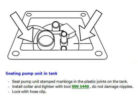

I noticed that my fuel gauge isn't reading my fuel level correctly. Recently i removed the fuel pump assembly to siphon some gas out. Apperently, I didn't put it in the correct position to properly read the fuel level. Now with that said, i seen a mark on the top of the pump assembly. Should that point a certain way, or is there other way or other markings to properly read the fuel level.

Two marks on the pump should align with two marks on the tank:

Thank you sooo much, thats what i thought cause with close examination, i seen the markings.....well this confirms it...thank you sooo much again bill.
