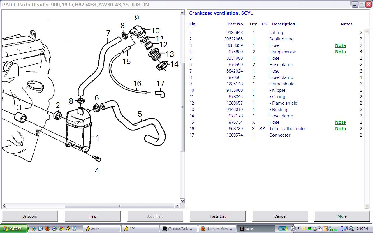

Oil Trap
http://www.eeuroparts.com/Main/PartDeta ... id=9497454
This is for a 960 but it looks similar to the S80 unit above. I think papa_4runner was referring to Part (4) Flange Screw, if so no special tool will be needed unless there is some obstruction not seen in the diagram which requires a special way to get to it
https://www.matthewsvolvosite.com/forums ... &mode=view

Yea the main braket that holds ac, power steering,alt is in the way
