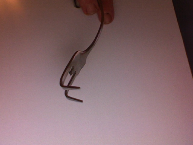

Your location says Preston. Would that be in Cambridge, Ontario? If so, come on out to Ayr, and I'll loan you the fuel line release and tank nut tightening tools I fabricated. They make the job much easier. Here's a pic of Snipercat's removal tool:
Mine's similar. For the tank nut tool, I formed a u-shaped piece of flatbar, notched to match the teeth on the plastic pump ring. A bolt was welded to the middle, to allow easy torquing of the nut on reassembly. I found I needed a proper tool like that to get the tank properly sealed after assembly. Also, lube the tank seal ring with a bit of vaseline prior to assembly. That prevents it from getting twisted up during the tightening process. That trick came from the factory service instructions (VADIS).
