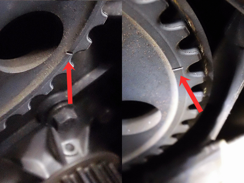

Giving myself ample time to work through replacing the water pump without a complete timing belt job. I have bookmarked MVS posts for reference, there are talks of aligning markings and notches to get it right.
I found these markers on the TB cover, what is its purpose?

The marks are timing marks for diagnostics purposes. You can't adjust timing so they have normal use. The later cars do not have them.
Do yourself a huge favor and mark the crank gear and the cam gears. If something moves and you end up questioning a hard to see original mark you can easily get it a tooth off. Chalk, nail polish, light touch up paint, a little spray paint sprayed into a paper cup all could be used for marking things. The factory cam gear marks are faint scribed marks and are not always aligned with the top cover marks well when the crank is at the right spot.

Are these crank and cam gears, which is crank?
The picture showing gears are how it is under the front cover (left and right), the left gear notch in close to 4 o'clock position, where the right has a notch at 2 o'clock. Are these notches that must be visibly marked?

Both of the upper gears are camshafts. The crankshaft is at the very bottom of the engine, where the serpentine belt is also attached.
Just mark the camshafts, mark the belt where it came off, and put it all back in the same position and you'll be fine.

Yes those are the marks/knotches. Here is how your Camshaft marks should be aligned:
If for some reason your marks do not line up, it's likely that the cam sprockets were removed at some point. In that case, align the crank and make new marks on the cam sprockets.
