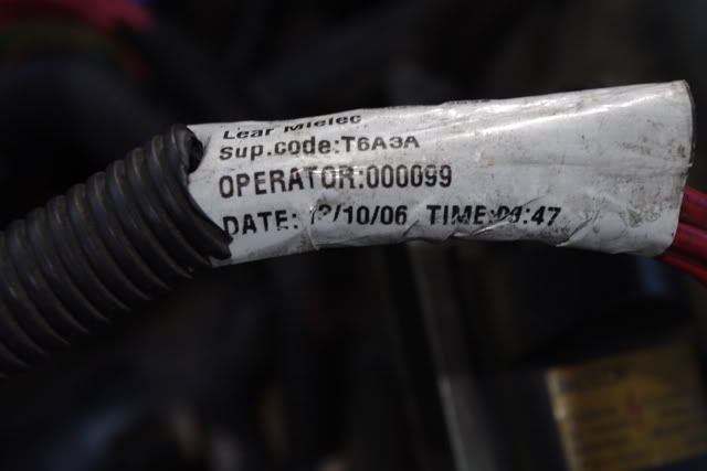

but somebody beat me to it. The tag on this B+ cable says 2006. It must have been replaced under extended service just before my mom gave me the car.

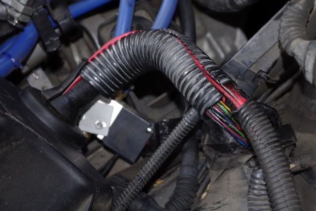

They also replaced the starter-to-battery cable. Below you can see the original one in the wiring loom cut off.

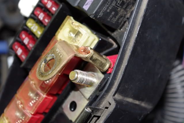

But back to the B+ cable. It looks good at the fuse box end.
And just a little tore up where it meets the starter cable at the battery terminal.
The engine is pretty well stripped down to the block at the moment, so I can't use my multimeter for testing. Should I just replace the B+ cable with this?
The B+ cable that's on there now says Made in Spain. I don't suppose that matters much if it's fried though.
I found a great write-up here, but he just cleans the cable. I'm still unclear on the replacement procedure. I think you cut the terminal off the old one and pull the cable out the bottom of the fusebox, but how do you get the new terminal in the fuse box? Do you have to pull out the rubber collar? I heard it's almost impossible to get back in.

ipdusa.com has the B+ cable. you do not have to take off the rubber grommet to replace the cable, just pull the fuse box down 18 inches or so and work the B+ cable out after cutting the old one, then work the straight part of new cable down through the fuse box and grommet from the top
