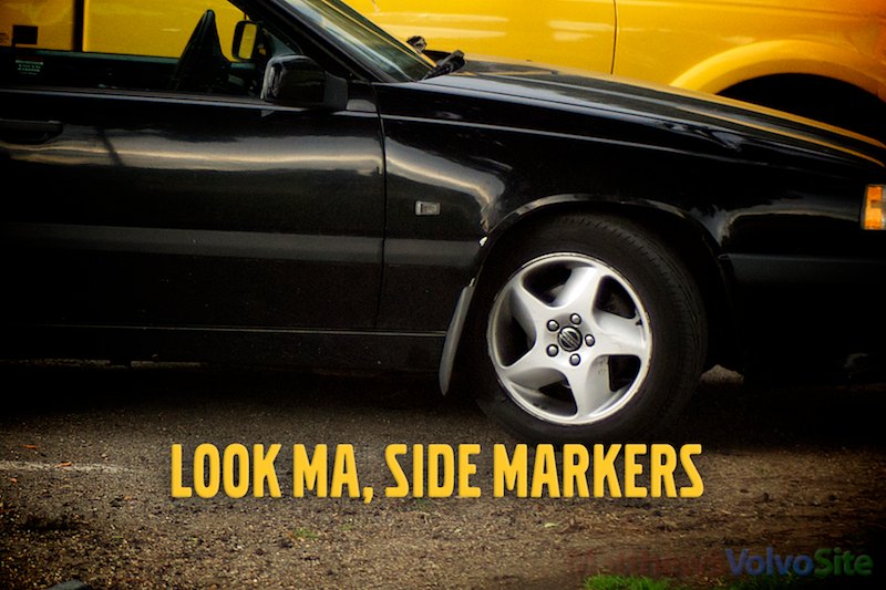

Get the Side Markers You Always Wished Your Volvo Had
Some P80 Volvos have side markers (most S70, V70, XC70, C70), some are pre-wired but have no lights (some 850, S70, V70, XC70, C70), and some have nothing (my 850, most [all?] 850s).
For those who have Volvo side badges but always wanted side marker lights, here's how to DIY.
What To Do
Open the hood.
Undo the spring to your corner lamps.
Release the wiring harness to the corner lamp and pull it out so you can work on it.
Wiring harness up close.
Splice into grey wire and green/blue wire (your wires' colors may differ) with several meters/yards (measure it out) of 18-ish gauge wire. My wire gauge is a little too big, but it shouldn't be a problem.
There's the mess I made. Actually, it's functional but ugly. After splicing with those timesaving splicers, I wrapped the splices in self-fusing tape. They should be durable and protected from the elements.
Attach the wires to a coathanger and thread them down the inside of the fender. I'll have a better photo of where to start them up soon.
Pop out your badge and weasel those wires right up to the hole. You might need another coathanger to grab the fist coathanger, to pull it in.
Wire your corner light harness to the wires, and plug in to your side marker lights.
Test.

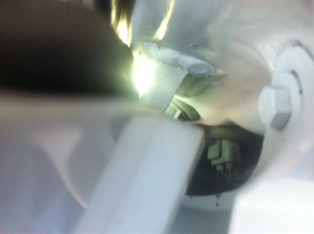

I know this is an old post...On my base 94 850 I found that it was already wired to accept the side markers. The wiring is held in place by a grommet probably to keep it from rattling. It looks like the wiring is going behind the dash but it is just held in place by the rubber grommets. You can see the wiring when you open the door and look into the fender. The wiring is located just behind the wiring that leads into the door. You can wiggle it free with your finger then fish it out with a coat hanger. The picture bellow shows it. It is the gray plug with two wires.

No need to run the wire as the connector works with your existing signal lights, if yours is pre-wired. Just remove the Volvo badges on the fender, clean up the leftover adhesive and install the side marker lights. I used some later model Vovlo fender lights found in the wrecking yard. Every 850 I have seen in the wrecking yard are pre-wired to accept side marker lights. Not to say that all of them came pre-wired there might be some real early models not wired. Look real closely as your V70 is likely pre-wired. The connector is gonna look like it belongs to something until you remove it. I had torn apart my dash several times and realized that there were no incoming wires from the direction those connectors were facing.
JR
